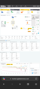

The same issue occurred last night. But the batteries never got below 52v. I've done the restart procedure but I cannot for the life of me figure out why the BMS is limiting my charge and discharge so hard... No faults I can see... Restarted a few times. At what point is this going to go back up to the normal BMS limits. It's behaving like I have two batteries not six, even though all six are clearly shown... I woke up to warning 26 and complete bypass to the grid...
None of the batteries were below 52 volts. I have the lithium protocol set to 1.
Screenshot 20260322 110507

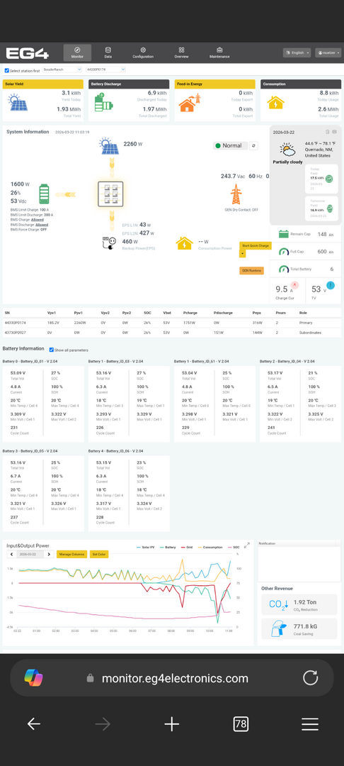

Okay even worse is that the views are completely inconsistent between apps. When I use the mobile app it shows that I have zero batteries hooked up....
The web app shows 6. No warnings. No faults. Have restarted twice now.
