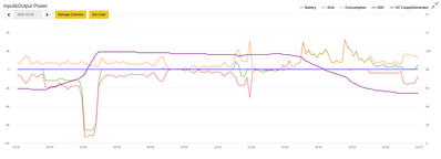

I have a GridBOSS with an AC coupled solar array attached to a smart port.  I have two FlexBOSS21 with two AllWeather batteries attached to the GridBOSS and the system has been working well.  The AC coupled solar input is being used to power the house, charge the batteries, and export to grid when solar production is excess of household needs.  Works as expected.
My issue is that the AC Couple line in the Input&Output Power graph is always zero.  It never changes to reflect the actual AC couple power.
In the Energy Overview bar chart, the AC Couple has a value.
Attached is a graph of Input&Output for Oct 26.  AC couple solar array produced 7.24kWh that day.
Screenshot 2025 10 28 14 08 54
 Is there a way the AC couple power can be displayed in Input&Output Power graph?

Can you provide your station name or inverter's serial number so I can look into this for you?

@eg4eric I have the same issue I Grid Boss and Flexboss21 to a new wall  battery and generator plug- added to my Solar Edge PV system. But never see the solar output data at all in the web or app.

AC Couple data will only show in this graph if it is connected to the inverter.

Private message sent to you with the serial numbers Eric, thanks for your time looking into this.
