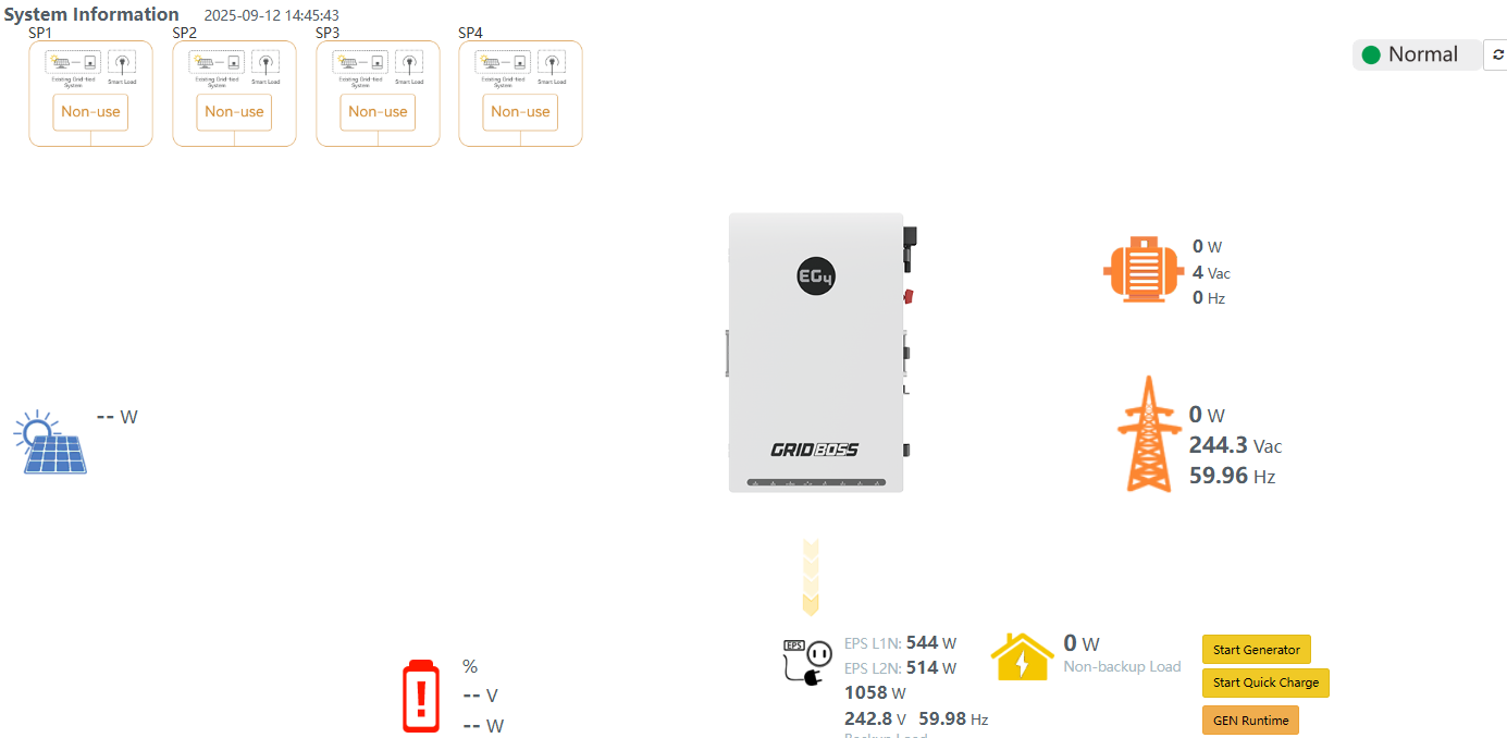

Hello,
I have been running the Gridboss + Flexboss21 (Grid+battery, no PV for now) for about 2 weeks now.  I am trying to figure out a few quirks
1) The monitor website for Gridboss does not seem to pull the correct info from the Flexboss21 with parallel options selected:

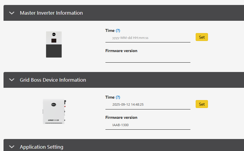

2) There is no master inverter selected for the Gridboss.  I did a read and it pulled the firmware for the Gridboss.

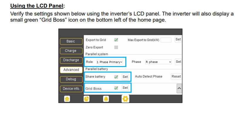

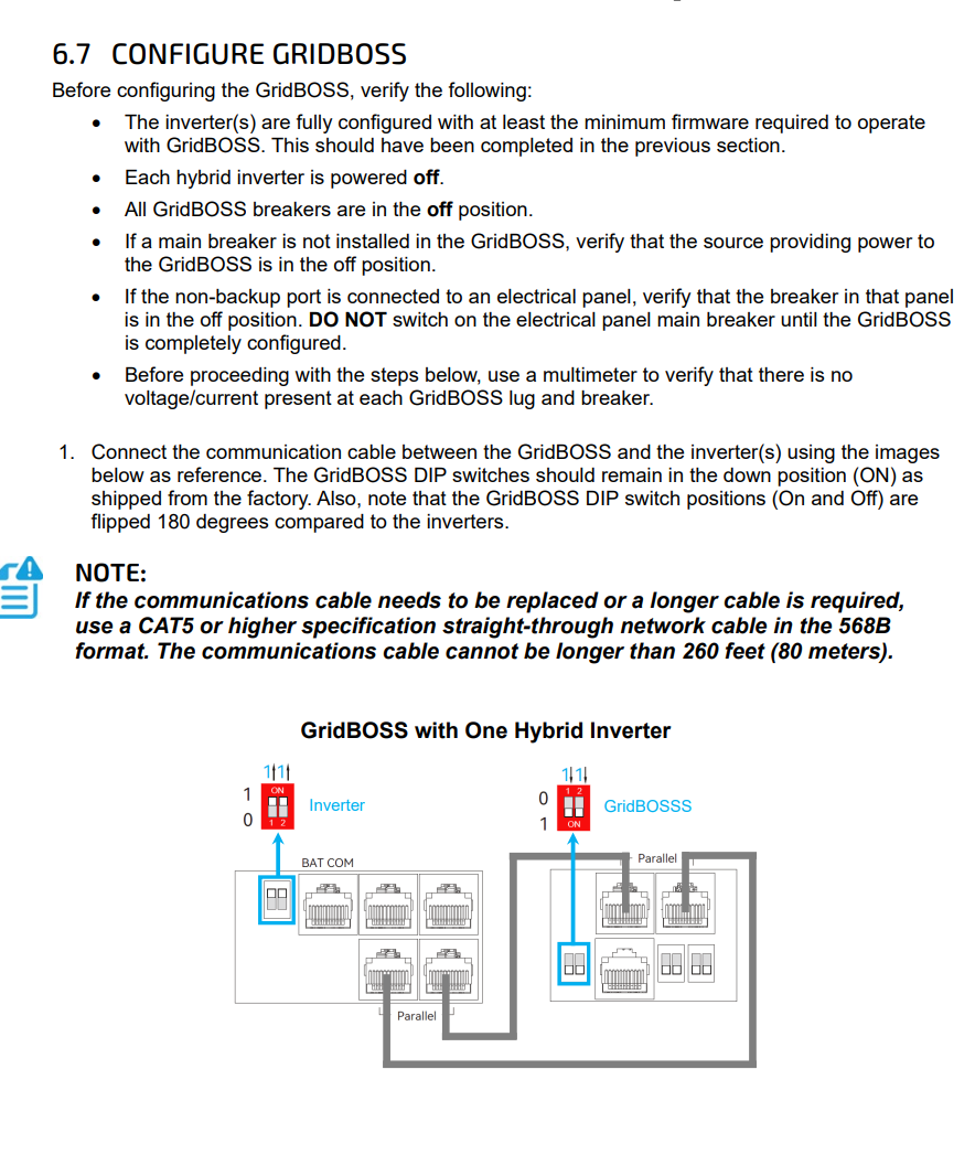

Make sure that the DIP switches are correct on both the Gridboss and the 18kPV. Also, make sure you have the Gridboss option selected on the 18kPV.
