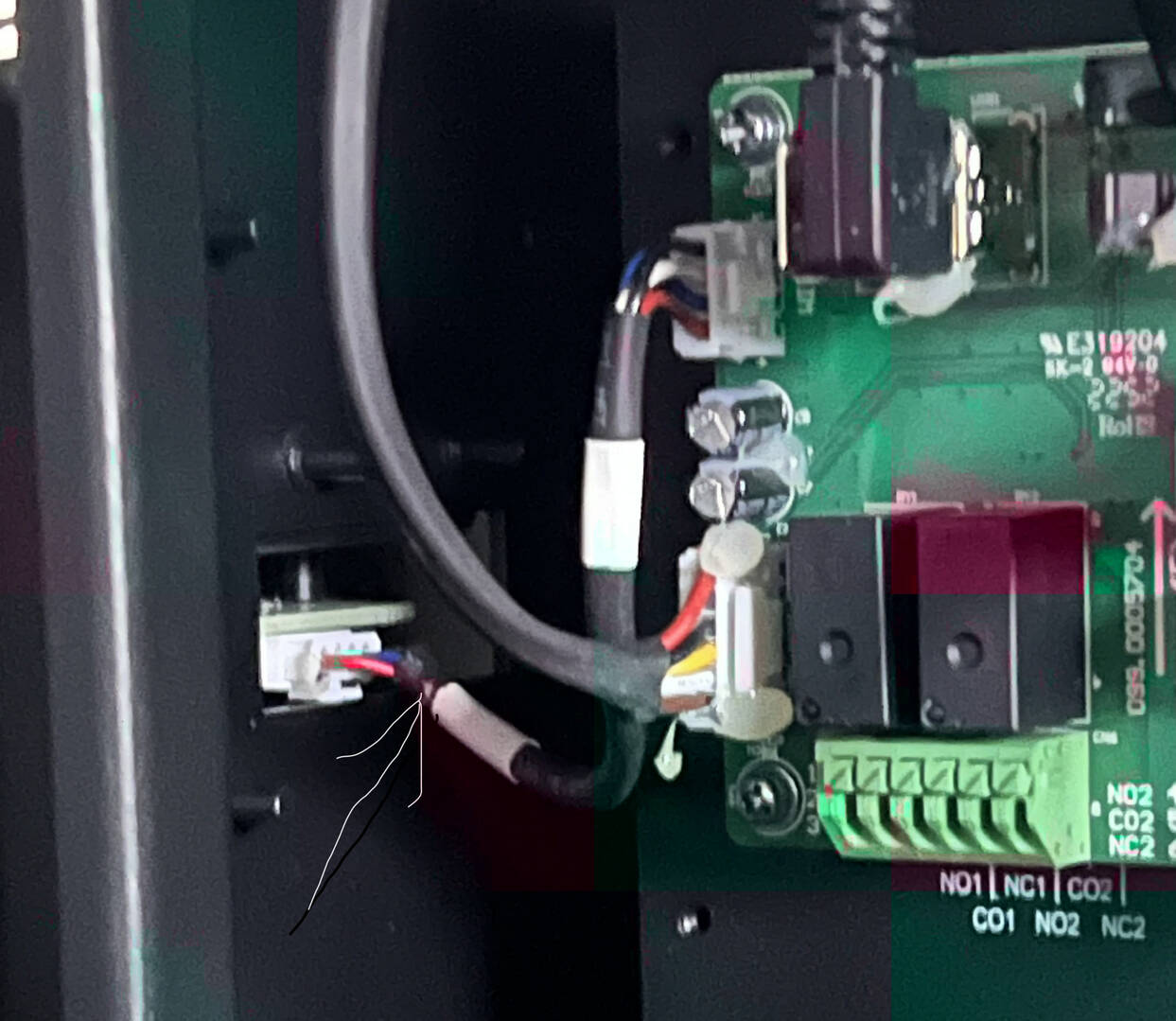

I too have intermittent connections issues with my Ethernet dongle. Every few weeks or months the top two LEDs blink (the bottom two stay on solid) and I can't access it from either my computer or app on my phone.
I suspected it might be the little cable that goes from the dongle plug to the PCB because at least once it seemed that wiggling this cable fixed the issue, but I haven't been able to repeat that.

Posts: 1294
@paulsandin Could you share a picture of the cable you're referring to? I’d like to provide it to our team for further evaluation.
(@paulsandin)
Joined: 8 months ago
@eg4eric
IMG 5704
It's the cable that goes from the Ethernet dongle to the PCB. My Ethernet is down again right now. Top 2 lights blinking, bottom 2 solid green. Can't access from phone or computer.
But like I said above, I can't reliably repeat the instance where wiggling or unplugging/re-plugging this cable seemed to fix the issue.
