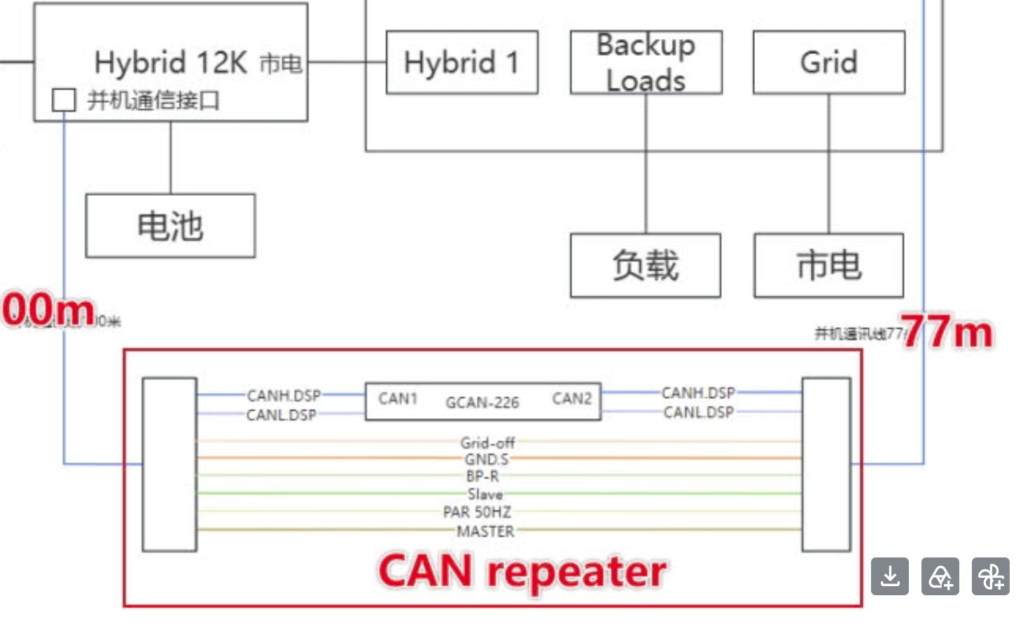

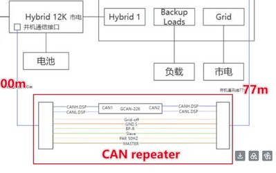

EG4 is re-skinned LUXPower electronics from China - the ports run CANbus and someone has reported successfully using a CANbus repeater:  A GCAN-226
Literally today, the one I ordered from China arrived today - I'll be able to try it next week.
