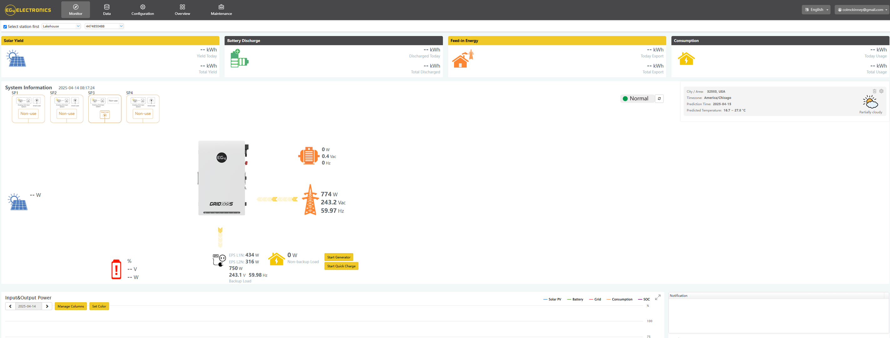

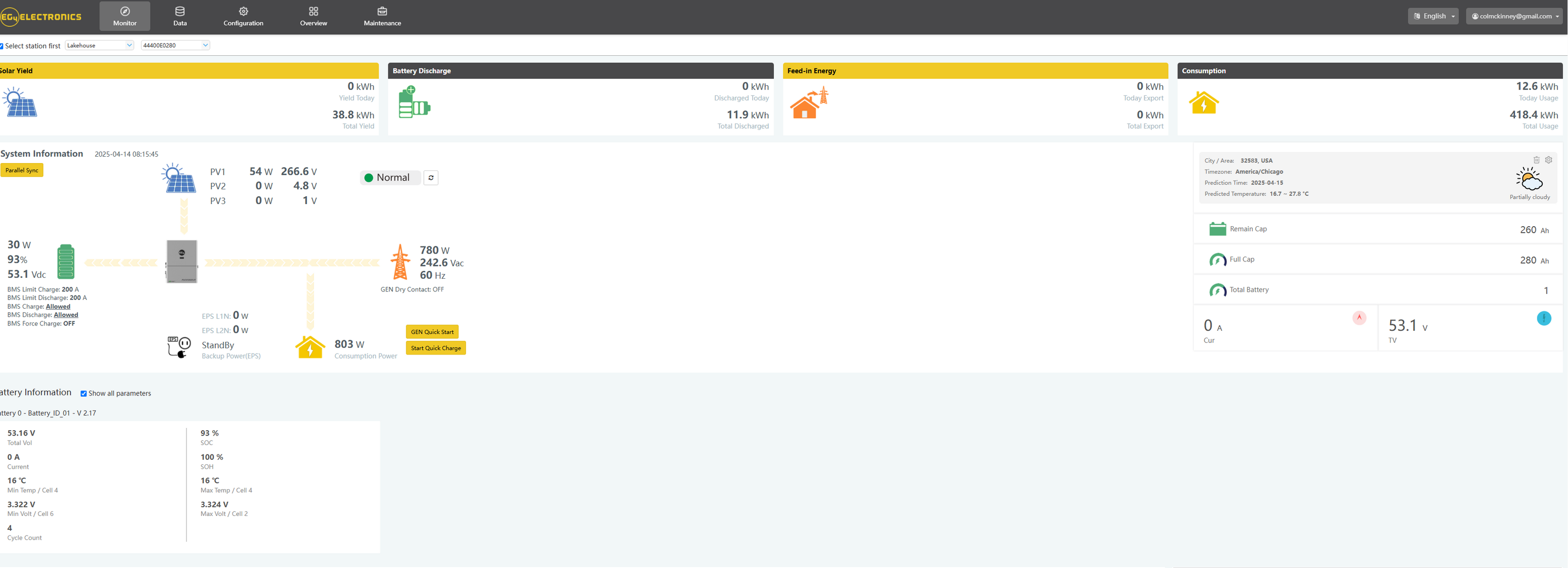

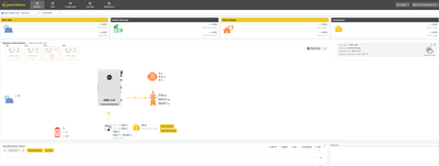

- If you have flexbox and gridboss should both be accessible from the web monitor or does one become 'master'? If I select flexboss everything looks ok, if I select gridboss half the data is missing (battery is a red icon).
- setting the MODE, what is the correct method? I managed to get into self-consumption mode for 1 day, have not been able to get back. Can someone share the steps to reliably get the system into self-consumption mode? (or any mode)
Thanks, hopefully the interface is getting an uplift at some point. This is flexbox and gridbox views, seems like the gridboss is missing data. If I should be using a specific device as a master would just need to know which one. Do you set the working mode from flex or grid for instance.

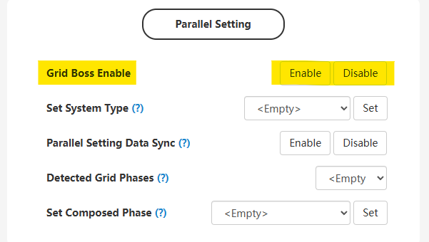

Make sure you have them in parallel, this will allow to show both as one. Also, make sure that the GridBoss setting is enabled through the FlexBoss21 settings.
See images below:

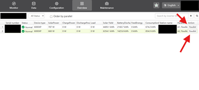

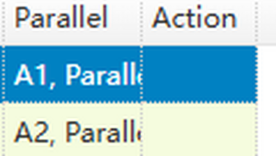

Posts: 10
(@colmckinney)
Thanks Eric, I see both displays the same now. I do not have the 'action' the same as your image - does that matter? Where would I change that if it does matter?

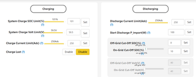

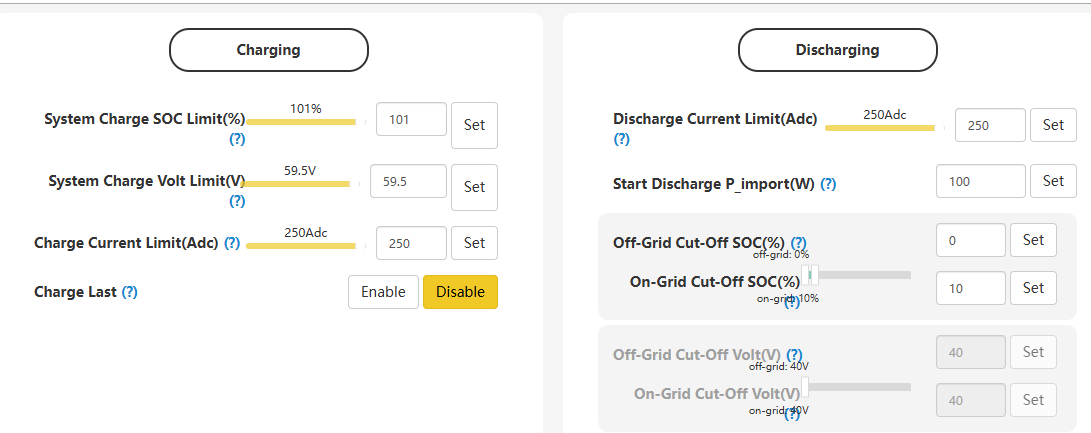

Posts: 10
(@colmckinney)
Eric, displays are looking better, I still do not see self-consumption mode. I must have a setting that is contradicting something. Here is my charge/discharge settings. The battery has not supplied load since Friday.
Posts: 1294
It appears the system is already set up in parallel.
Also, make sure that the battery backup mode isn’t conflicting with any discharge settings.
