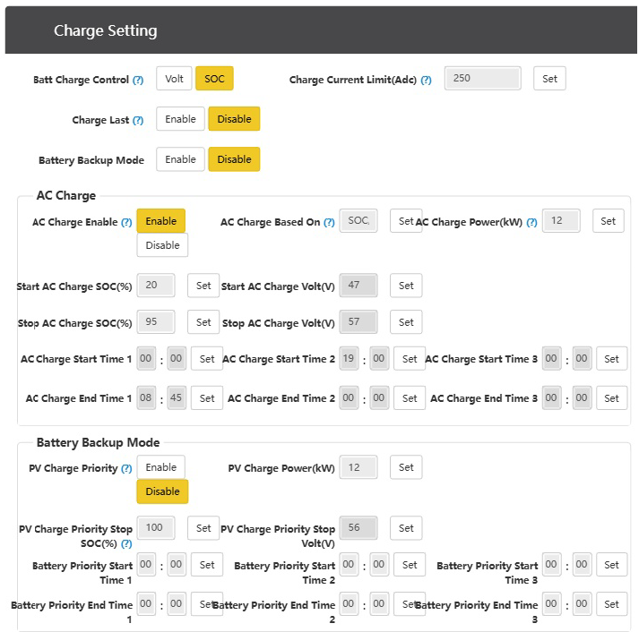

Posts: 99
Our Charge Settings screenshot below.
The good: It generally is behaving as desired, running on battery during the day, charging at night.
The bad: I have to fiddle with the Start AC Charge SOC% at the end of the day to ensure it tops off after midnight, but before our 6am start to the peak rate schedule.  If we don't discharge down to that start percent we could start the day close to the threshold and then the AC Charge would kick in w/in the increased rate time.  We always want to top off at 4am.  Not sure how to force that.  Looking to @eric (EG4) for guidance and maybe some software tweaks to help us out.
Here's a link to our utility rate plan that we're trying to config to. https://www.consumersenergy.com/residential/account-and-billing/rates/electric-rates-and-programs/rate-plan-options/nighttime-savers
