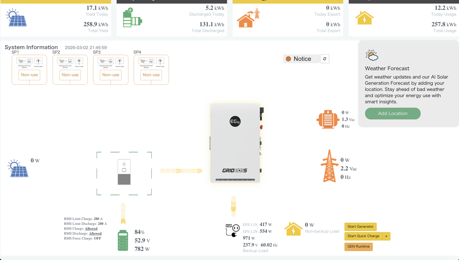

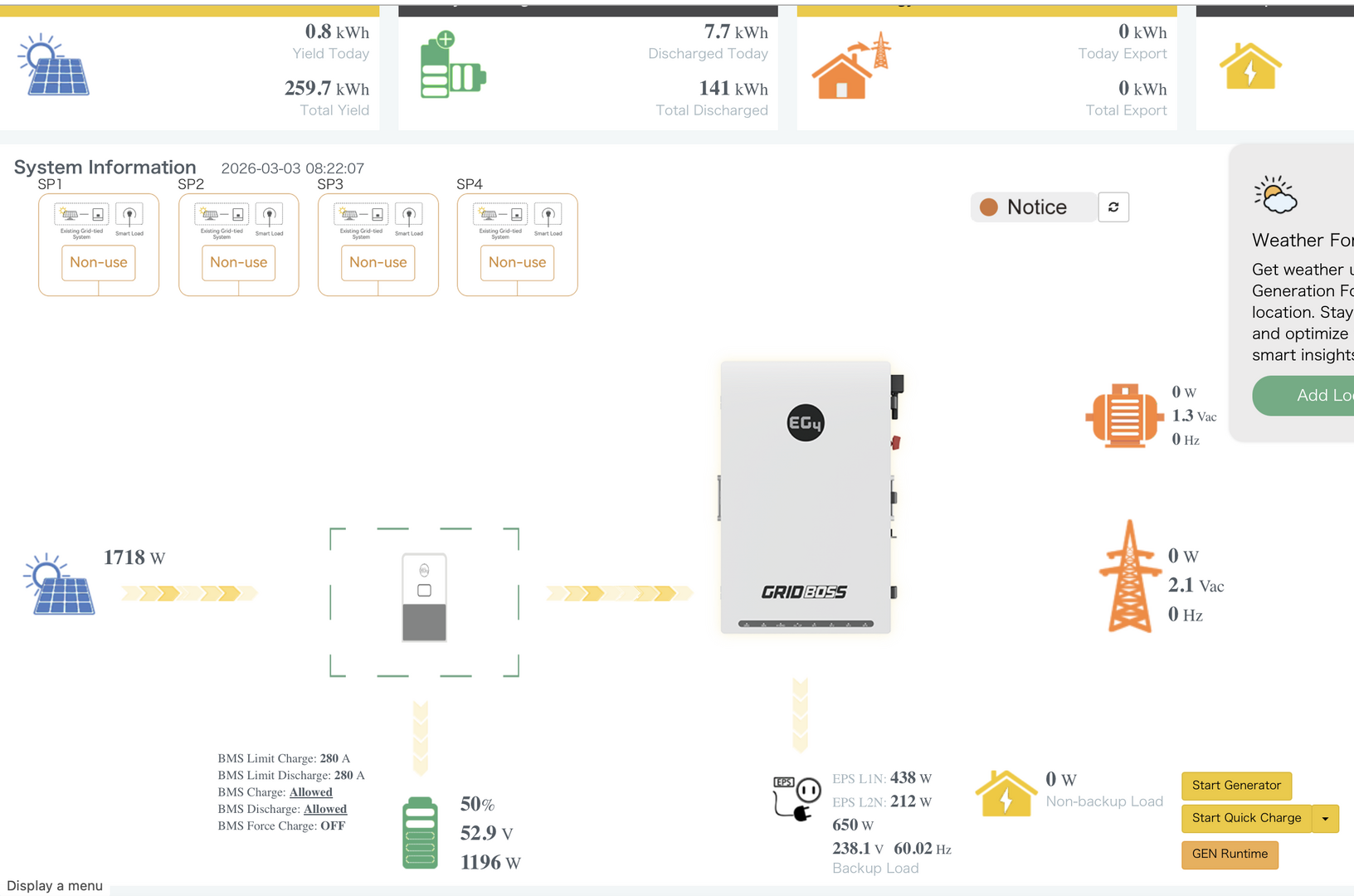

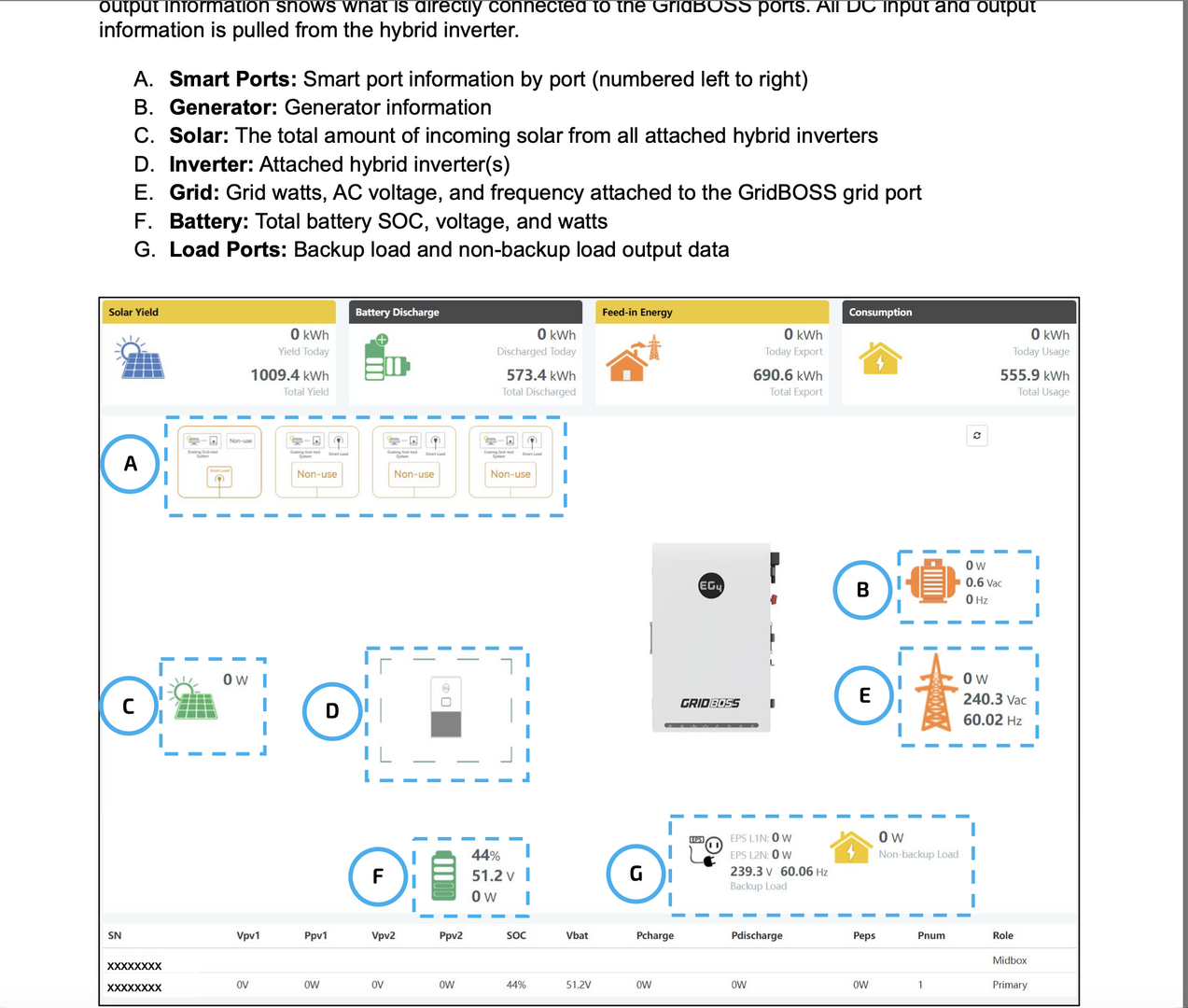

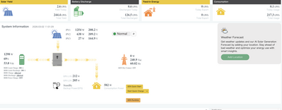

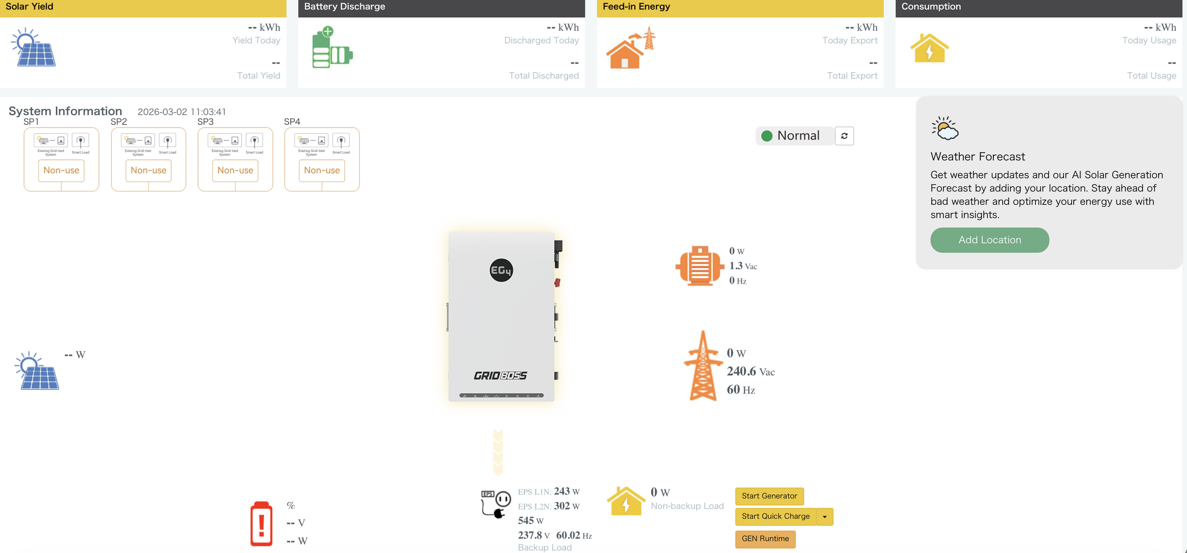

Hello my system appears to be working but gridboss is not showing the inverter, battery info, or pv info like shown in the gridboss manual.
Image 3 2 26 at 11.16 AM
Image 3 2 26 at 11.04 AM
Flexboss21 seems to be showing correctly when viewing flexboss page.

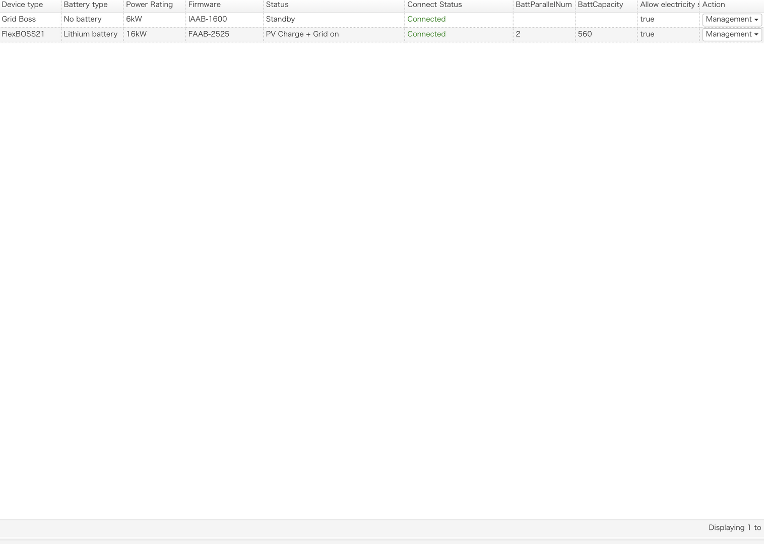

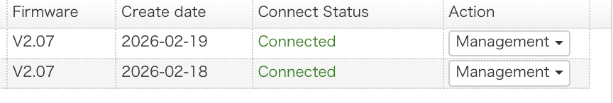

and dongles for flexboss and gridboss show connected
Interestingly I also noticed on this device table column show "allow electricity sales" to yes, but both devices are set to zero export, and disabled grid sell back

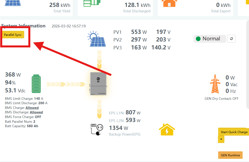

You should see a Parallel Sync button on the top left of your screen through the inverter page. If you don't see this let me know and I can sync them together for you so you can view your whole system together like it shows in the manual.

Thank you I did have that button on the flexboss inverter page on the website. I clicked "parallel sync" and looks like it works now
Now when I select any of the devices serial number on the monitor page, where before would take me to flexboss or gridboss page, it takes me to this page and I'm assuming that's how it's supposed to work, Thanks
