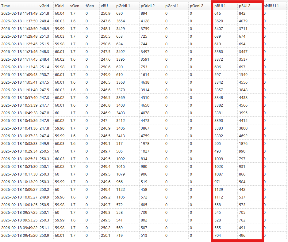

Hi. I have just finished installing the grid boss and two flexboss18s. I have the inverters setup as master and the second one as the slave with the proper cat6 cabling for parallel usage. When I go into the command center it shows as the primary inverter using the electricity not the grid boss. At this point no batteries or solar is installed, just the inverters and grid boss. Here is the screenshot, any ideas?
Data
I don't believe it will show data on that screen since the Gridboss is not an inverter. However, if you go into the Data history tab, you can see that it's showing how much the GridBoss is sending to the Back Up Loads.
