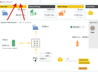

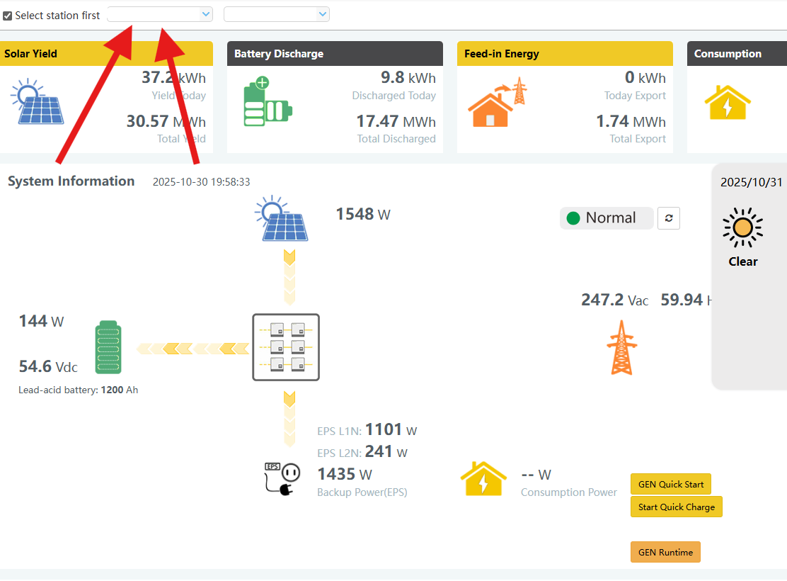

@ray
I can attempt to create a Station name and user account, which will look like this and where the arrows are pointing the station name will show.
Are you able to attempt to create an account and register the dongle one more time before I create it for you?
If it doesn't work, let me know and I can send you a private message so I can gather the information needed.
