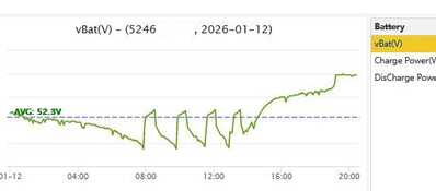

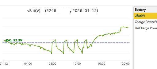

I got a contact from EG4....but there is no fix yet. I still see voltage stuck at end of charge rather than relaxing to float once charge is complete.
260112 stuck at 56
