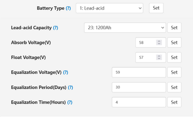

My system is an EG4 12000Xp with 24 6V Rolls deep cycle batteries arranged in series parallel for 48V, and 1100AH.

The issue is low rate of charge. We are completely OFF GRID

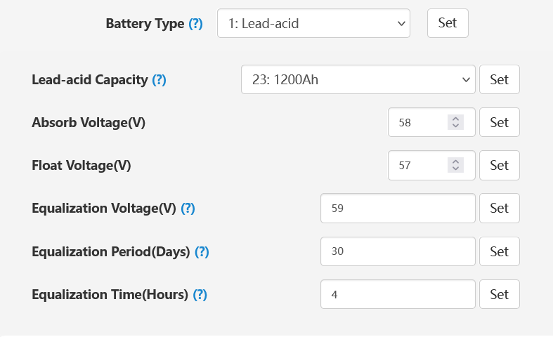

I have the settings maxed out, but even with the batteries down close to 48V, I can only get a maximum of 51.5V charge.
This same system used to produce 60V (Rolls recommendation) when it was charging through an Outback Flexmax 80 and equalize at 63V. (Panels were series parallel and just the 9 445w at that point).
So, what am I missing in the settings? I know I can't get higher than 58V, But I want to see that 58V, or I'll be spending a lot of time and $ with the generator this winter.
Is there a software issue? currently ceaa-000707
I have bumped the battery AH by 100 to see if I could trick it into a higher charge rate, but It's raining today, so no can see.

ISSUE RESOLVED!!
I had been reading the AH rating on the battery, but not looking really closely. Each battery has a 428AH rating for 20hrs. I had used the much smaller 10hr rating. So, total bank is 3424AH, not the 1100 I had in initially
MUCH relieved!
THANKS VERY MUCH FOR YOUR CONSIDERATION!
Posted : August 23, 2026 3:46 pm
(@hunter1can)
Posts: 4
Well can't go back and edit that, the AH total is of course 1284. Regardless, I no longer have an issue.
