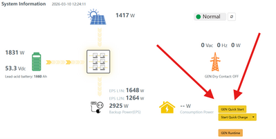

New Features 1 & 2, I can't find setting for those features on my 12000XP's.  Are they enabled on these inverters?

@wardo5757
I believe for the 2nd feature, it's for the Gen Quick start on the Monitoring system.
For the first feature, I'm not 100% sure. Let me ask about this.
