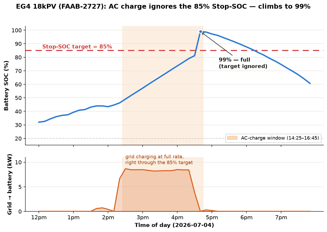

  • Test A: Stop SOC set to 85% at 14:09 — 16 minutes BEFORE the 14:25 window opened (ruling out "changed mid-window"). Battery grid-charged straight through 85% to 99% by the window's end. Net solar (PV − load) was negative after ~15:15, so the whole 56% → 99% climb was grid charging.

Follow-up / clarification (please disregard my 85% example):
Since posting I identified a SEPARATE issue with my battery's SOC gauge — the pack's
reported State of Charge freezes near 80% and then jumps straight to ~100%, skipping
81–99%. (3rd-party Docan/JBD-type BMS; reported to the battery vendor separately.)
That means my Stop-85% example is NOT clean evidence — the inverter never actually
"saw" 85%. Please set that one aside.
The core finding is unaffected and rests on gauge-independent tests: with Stop SOC set
to 45% — a mid-range value the gauge reports accurately (43 → 45 → 46 → 47 in order) —
"Time + SOC" grid-charged straight through 45% at full rate (~11 kW) with no throttle
and no stop. A Stop-35% test behaved identically. So Time + SOC ignores the Stop-SOC
target regardless of any gauge behavior.
Findings 2 (AC Charge Power setpoint ignored) and 3 (SOC mode stops cleanly at 53%)
are also independent of the gauge. Happy to share the 15-second logs and a chart.
