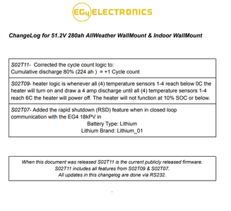

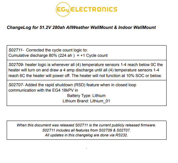

This is the changelog below ⬇️
You don't have to update it, but you can, so the batteries are up to date.

@EG4 Eric is correct... the updates are for communications with EG4 equipment.
