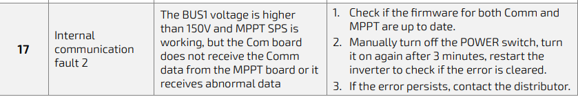

Hello, I just went to check the system for a neighbor who is not home (system: one XP6000 inverter, one 280Ah battery and 8 solar panels)
The inverter was flashing a #17. I checked the battery connections and there is 0 volts… the battery is about 3 months old…. The house was not even being used and there was practically no load on the system. I tried rebooting twice  all but nothing changed. Anybody has an idea? Thanks!

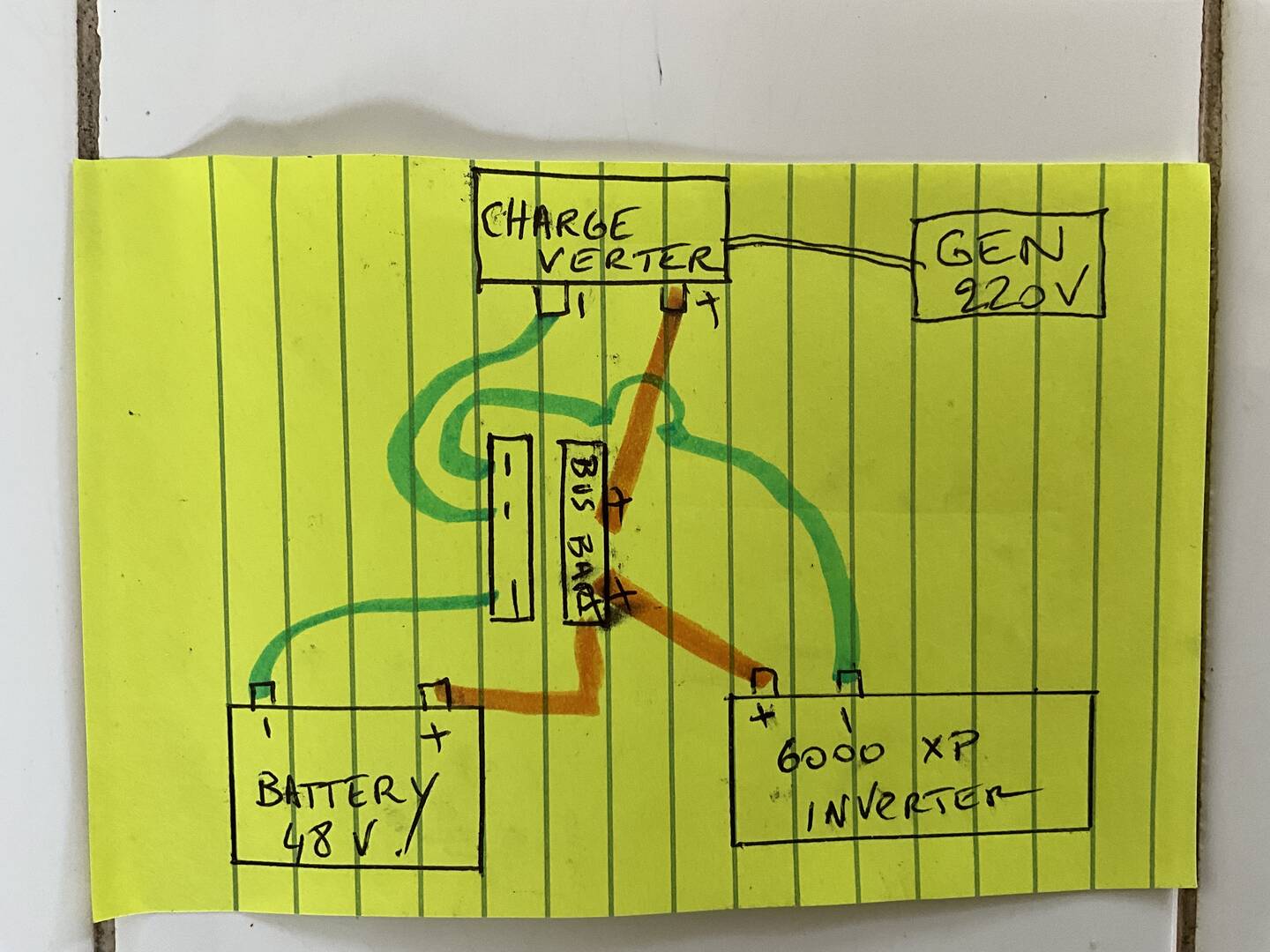

Another question, please! I am going to get a Chargeverter to try and charge the battery: i am planning on adding a bus bar for the negative and positive and connect the battery, Chargeverter and 6000XP to it. Is that the correct way to do it?
Posted : September 2, 2025 4:49 pm

Posts: 1303
@ravasunpower
Yes, that looks correct. You will connect the chargeverter and the batteries to the bus bars and then run the connection from the bus bars to the inverter.
