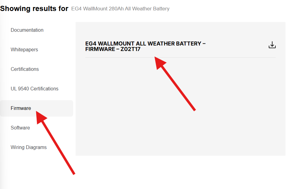

RS232 Firmware- S02T18
RS485 Firmware- Z02T17
You can download the RS232 firmware and changelog through our EG4 Website. Under the Firmware Tab. (File will be under Firmware-Z02T17)
EG4® WallMount All Weather - EG4 Electronics

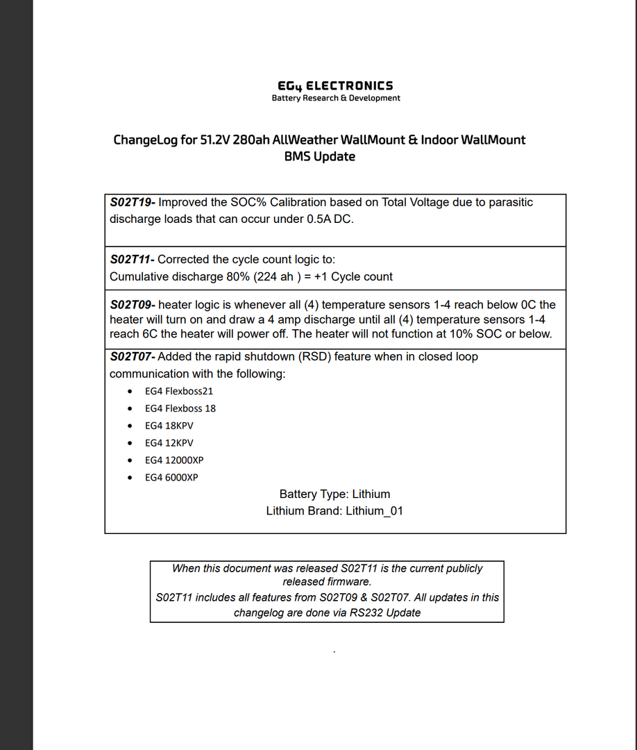

where is the changelog?
Posted : January 8, 2026 5:12 pm
(@clarktheshark)
Posts: 24
Found it in the zip file

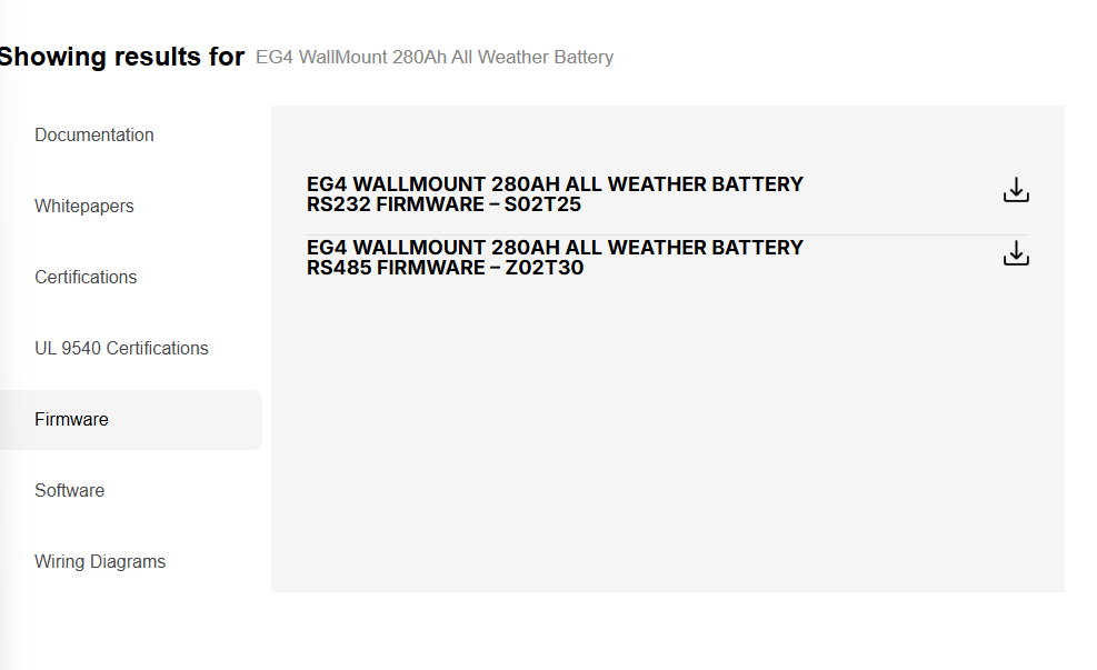

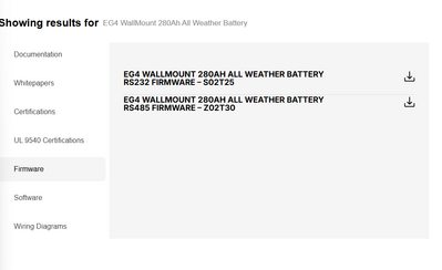

Never mind, that's not the latest release anyway.
Any chance you can point at the latest release of both RS232 and RS485 complete with release notes?  It's a treasure hunt every time to find the latest of everything.
Posted : July 24, 2026 1:01 pm
Posts: 1303
@wpns
If you are referring to the All-weather WallMount batteries, the latest firmware is S02T25 for the RS232 and Z02T30 for RS485.
You can find then with the changelog on our website.
EG4® WallMount All-Weather Firmware
