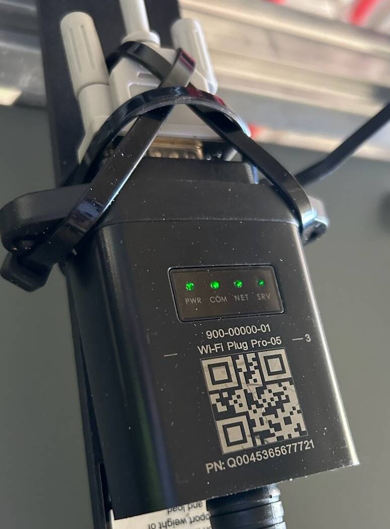

something is wrong again. I  just installed another 3000, and CANNOT get the dongle configured.
- I have updated to SmartESS app v3.40.1.0
- I can "see" and connect to the dongle on phone wifi, but cannot see it in BT
- I have an account set up in SmartESS, and can login to my existing account when connected to home wifi, but when I try to +add the new device, I can't because it is never found by BT scan, and can't be added by wifi as far as I can tell in the App
enviro3k01 Q0045365677721

@eg4eric tried that.... the app seems to look for the PlugPro-05 with BT, and never finds it, so I am stuck with no way to teach the dongle what the home wifi/password is.
Posts: 1285
@dtbaker61
You need to be connected to the dongle's network first so the app can find it.
I'm attaching a video that could help. You can start the video in minute 2:00
Although this is not an EG4 video, the process is very similar.
WiFi Plug Pro Setup & SmartESS Monitoring! Full Step by Step Solar Guide 2025!
(@dtbaker61)
Posts: 153
@eg4eric I finally got the dongle to connect w the home wifi,,,,,
BUT, now I cannot "add device" to my pre-existing SmartESS account. I had installed another client with an eg4-3000, and finally got it reporting about a year ago, so I'd like to leave that in my account. Is it possible that the SmartESS really can only be set up to monitor ONE site ? perhaps I need to delete my user account, the old device, and "register" new from scratch ?
Posts: 1285
@dtbaker61
You’ll need to create a new account. If you were running multiple units in parallel, they could be added to the same account. However, if this is an entirely different system, a new account is required.
(@dtbaker61)
Posts: 153
@eg4eric , AHA! so this is a big problem for someone like me who is actually an installer and would like to look at multiple units at different physical addresses, networks, accounts.
But, I suppose I can create a dedicated gmail account for each site, which forwards to my "real account" I will give this a try.
I would suggest to your support team, and user documentation that you clarify that you need a unique email account for each unique physical site if you want to be able to monitor different sites at the same time.
Posts: 1285
@dtbaker61
Yes, I agree, and I will pass this along to our team. Thank you!
