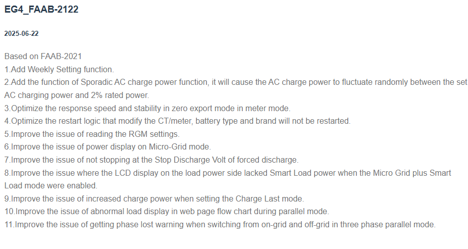

http://os.solarcloudsystem.com/#/releaseLog?deviceType=LXP_LB_8_12K
EG4_FAAB-2122
2025-06-22
  • Based on FAAB-2021
  • 1.Add Weekly Setting function.
  • 2.Add the function of Sporadic AC charge power function, it will cause the AC charge power to fluctuate randomly between the set AC charging power and 2% rated power.
  • 3.Optimize the response speed and stability in zero export mode in meter mode.
  • 4.Optimize the restart logic that modify the CT/meter, battery type and brand will not be restarted.
  • 5.Improve the issue of reading the RGM settings.
  • 6.Improve the issue of power display on Micro-Grid mode.
  • 7.Improve the issue of not stopping at the Stop Discharge Volt of forced discharge.
  • 8.Improve the issue where the LCD display on the load power side lacked Smart Load power when the Micro Grid plus Smart Load mode were enabled.
  • 9.Improve the issue of increased charge power when setting the Charge Last mode.
  • 10.Improve the issue of abnormal load display in web page flow chart during parallel mode.
  • 11.Improve the issue of getting phase lost warning when switching from on-grid and off-grid in three phase parallel mode.

Here is the changelog for the new firmware.
