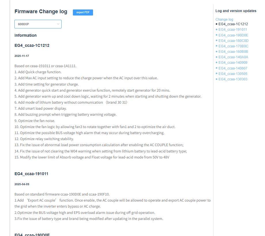

There is a new firmware update available for the 6000XP (EG4_cca-1C1212). If you have any questions about the update or need assistance installing it on your inverter, please let me know.
