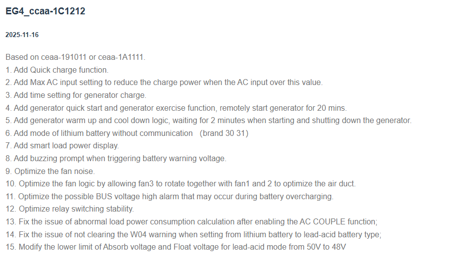

Update went smoothly.Ā  Where can I get the latest changelog?Ā Ā

Posts: 1263
@goingsolar Ā
Posted : December 16, 2025 9:04 pm
