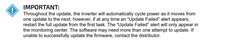

Throughout the update, the inverter will automatically cycle power as it moves from one update to the next.
It's best if you have the modem and router on a power source that will not turn off.
You can also update the firmware through the app. It doesn't require the inverter to be connected to the internet.
