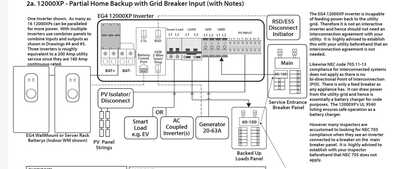

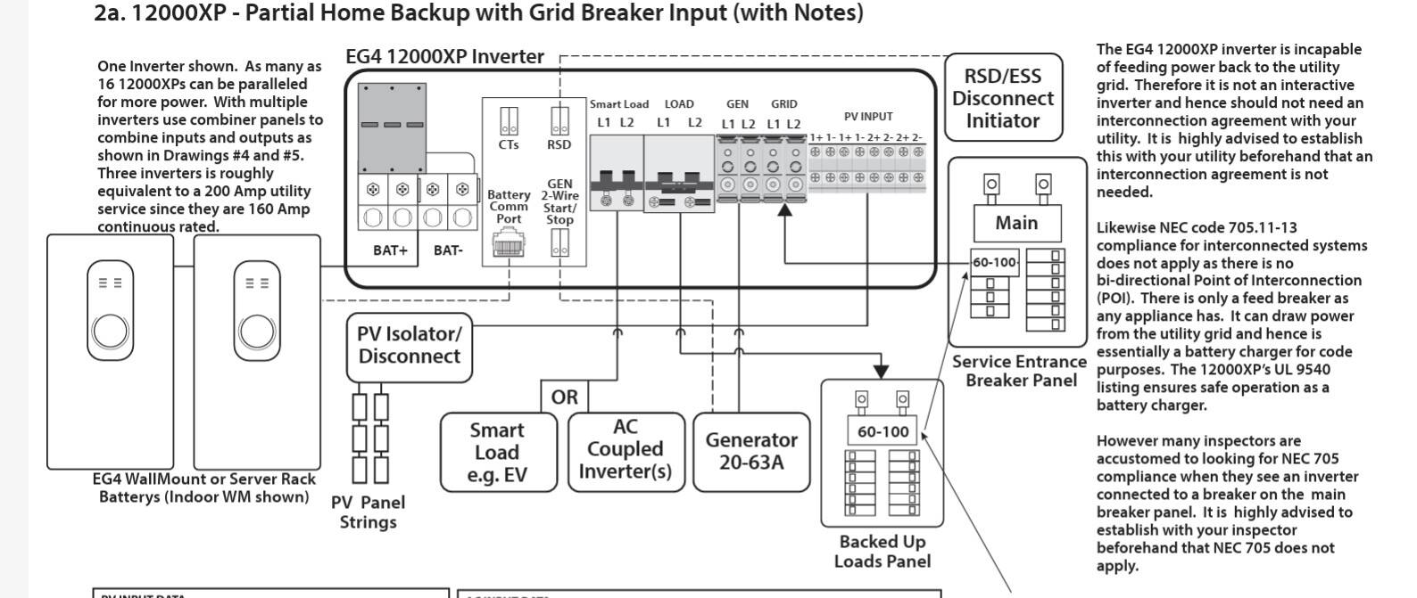

If the 12000XP is wired as pictured do you have to comply with UL9540? Or does it not need to because it isn't actually grid tied and there is no actual point of interconnection?
12000xp
Posts: 1297
You would need to check your local code and utility requirement.
