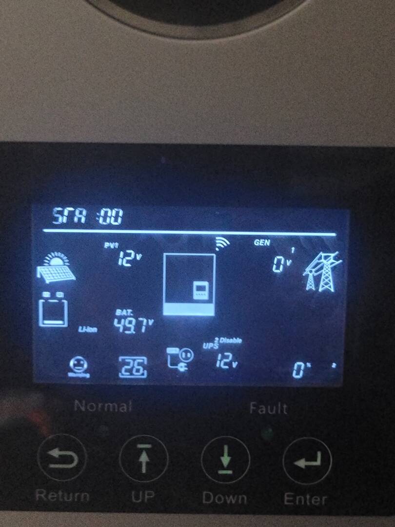

LCD in standby: 12V PV reading and warning 26; this is not a photo of Fault 17.

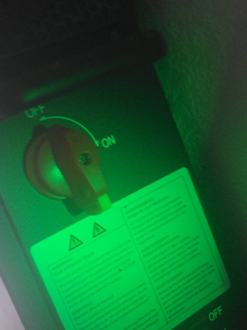

PV disconnect switch.

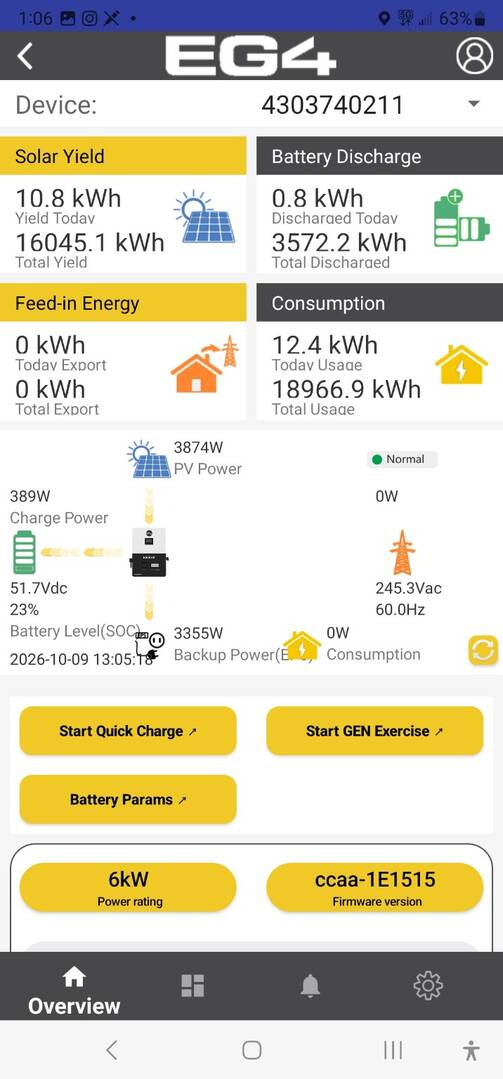

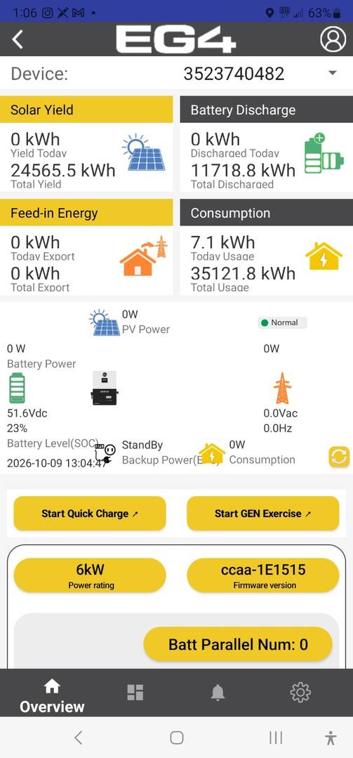

Affected middle inverter app screenshot: standby, 0W PV and firmware ccaa-1E1515.

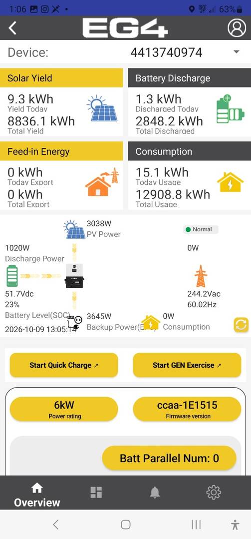

Other inverter: 3874W PV and the same firmware.

  4. Is approximately 12V displayed on disconnected PV inputs normal, or could it indicate an internal MPPT problem?
    It should not be reading any voltage. This could be contributing to the issue, but further troubleshooting would be needed to determine the cause.
