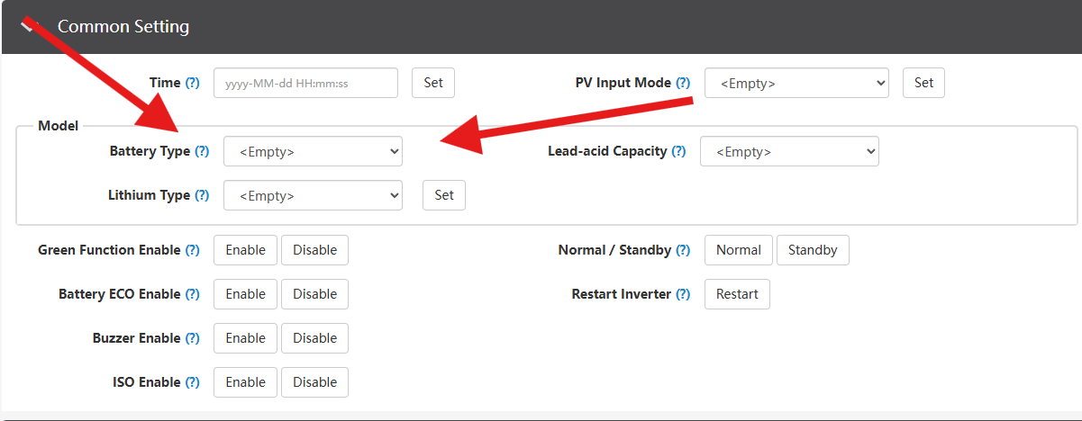

I'm just powering up my 12000XP installation. I'm using 5 x 100ah Lifepo4 batteries that do not have BMS comms capability. The battery bank does not show on the home screen, but when I look at data screen, it shows the battery voltage. I have "Warning 000" battery communication error, so I'm guessing I don't have the unit properly configured for batteries with no comms?

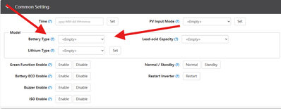

In your inverter's settings, you need to change the Battery Type to Lead acid
