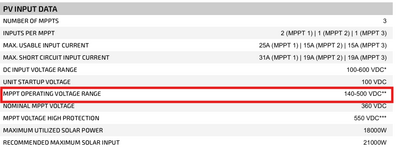

I am trying to adjust the "Start PV Volt(V)" below 140v and it doesn't seem to be alloed. Is there a way to do that so I can support 4x405W panels on pv2 or pv3?

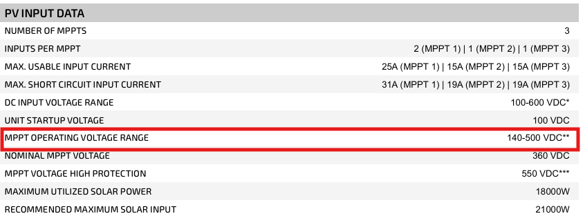

For the 18kPV the lowest that it can be set to is 140v.

I don't know what inverter you have but there should be a setting where you can lower the start PV Volt (under PV setting).
This could help some if it's never starting. Note that as Eric stated. The minimum that MPPT can operate is 140vdc (assuming this is your inverter). If your total panel voltage is under that then you will never get into the maximum power of your panels. The inverter may come on but again, you wont see the power that your panels are capable of. Your best bet would be to add at least one additional panel of the same make & model (but possibly more). This may bring up the voltage enough to get into the inverters minimum MPPT voltage. What's the MPPT voltage of your panels? Printed on the back.
