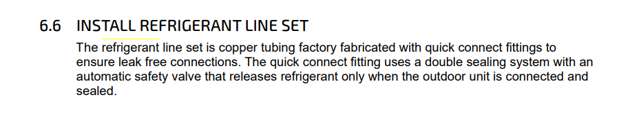

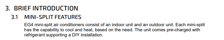

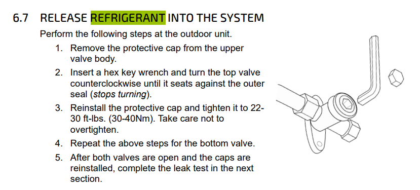

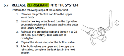

Yes, the Mini splits units come pre-charged refrigerant.
EG4-AC-DC-Plug-N-Cool-Solar-AC-Manual-12K-24K.pdf
