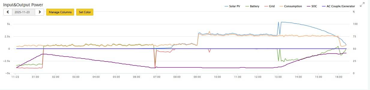

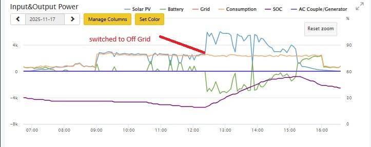

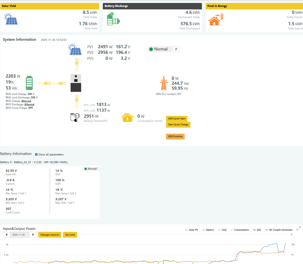

I've been having some confusing charging behavior with my 18kpv over the last week that I can't quite figure out. Take yesterday for instance, panels were in full sun but solar was only offsetting the load but not charging the battery. Since I know this was working in Off Grid mode, I switched that on and it immediately began charging the battery while offsetting load as shown on the chart below at 12:26pm. With no other changes, why would this correct the behavior?
I have been reading on other forums that many people are running into this same problem. Works in "Off Grid" mode, but with "Off Grid" off and Zero Export on it will only power loads and not charge the battery from PV unless you set PV Priority to battery (which is opposite of what I want)
Update: Leaving it in Off Grid mode resulted in the same problem the next morning. Switching Off Grid off or on though didn't change anything and I had to restart the inverter to get the batteries charging again off pv.
I am on the latest firmware.  I don't believe this was happening before my last firmware update though.

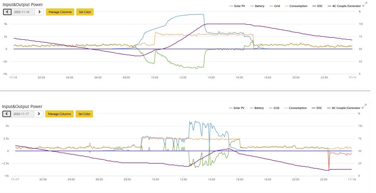

For reference, below illustrated a typical load/charge scenario where it worked correctly.  My loads are automated so they are always the same and the battery is usually fully charged by mid day.  The second illustrated this new problem where the PV ramps up to cover the loads but never begins charging the battery until mid day when I notice it and manually intervene, either changing the Off Grid setting or rebooting the inverter. The second day was light scattered clouds but it should still have the basic pv charging outline as the top graph with momentary cloud spikes as it does the second half of the day.

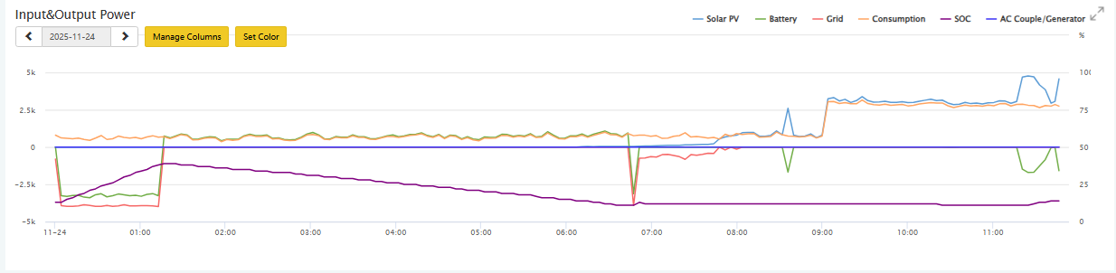

So this morning it appears to be doing it again. When the loads turned on, solar immediately jumped 2500watts to meet the load but had not been using that to charge the battery. Now the solar production is only following the load and not charging the battery.  I am in Off Grid mode but cut over to Grid due to low SOC. My loads should be going through EPS, but it hasn't switched back over due to not charging the batteries back up.

So it finally switched over to EPS on its own at 1:01pm then back off and back on again at 1:09pm when if finally stayed on and started charging the battery.  I looked at all my settings and do not have anything set anywhere near 1pm but found it odd it was so on the hour. Up until that point it used PV to follow the load only with no charge to the battery.  It was full sun all day with no clouds until almost sundown.

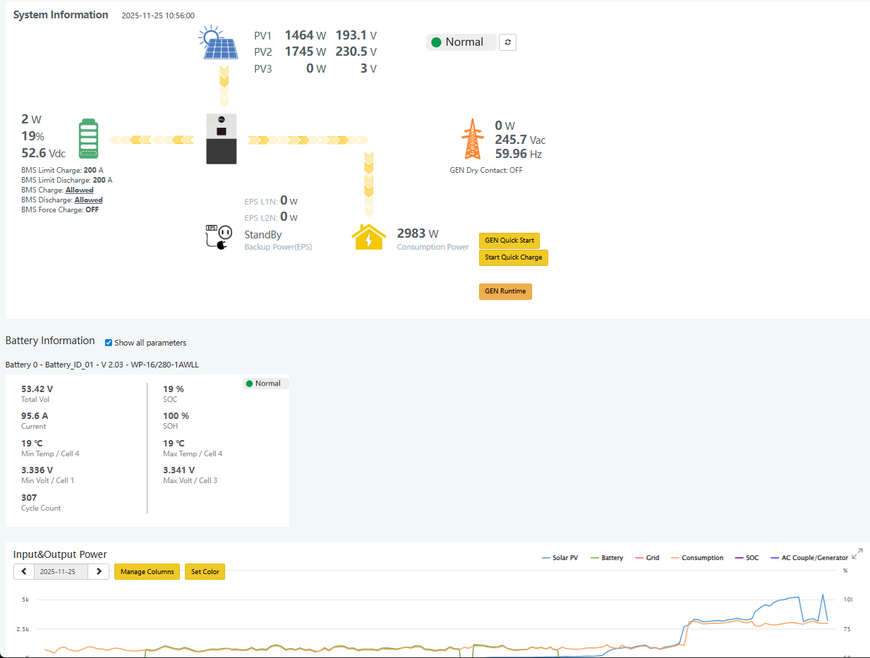

It did it again today but I couldn't leave it that way and miss another day of charging. It seems like in Off Grid Mode, once the battery gets down to the cut out SOC and switches to the grid, it wont charge the batteries from PV until some random criteria occurs long after PV is plentiful. And once it does finally figure it out, its is only momentary at first, switching back to grid and in failure mode again. I had to reset the inverter to correct it.

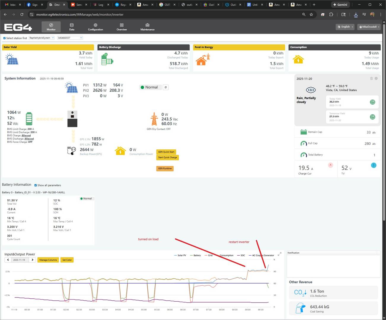

It did it again this morning.  Battery was depleted down to 12% (battery cutoff is at 10% which had happened), in Off Grid Mode, EPS relays were off and it was powering loads with the grid.  Solar production matched the load and it never started charging the batteries.   I once again reset the inverter.  EPS relays were on, and PV began powering both the loads and charging the battery.
As an additional test, I waited a bit for the battery to get up to 18% then turned off 'Off Grid Mode'.  EPS relays turned off, PV continued to power the load but battery charging stopped and would not continue.  This all started with the latest firmware, and I noticed this firmware has a line item that addressed this very issue with the GridBoss:
  • 16.Improved stability when switching between on-grid and off-grid modes if the battery discharges to the On-Grid Cut-Off SOC/Voltage while running with GridBOSS and set to Off-Grid mode.
I waited a bit to get some logs. Since I need the battery to be charged, I switched it back to Off Grid Mode, the batteries immediately began charging.
