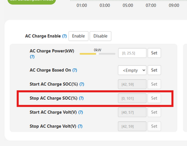

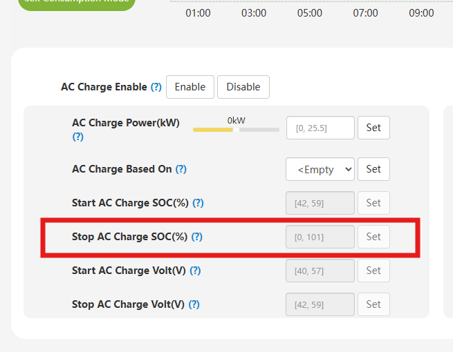

@david271
At this time, the weekly setting can only be adjusted up to 100%. However, you can navigate to the Working Modes page and adjust the Stop AC Charge SOC% there, which can be set to 101%.

(@mccorb)
Posts: 18
@david271 I would think that the charge settings in the working mode would limit the charge and you couldn't get it high enough without maybe switching away from state of charge and using voltage instead. If it does work please post back and let me know.

@eg4eric Interestingly if I try setting "Stop AC Charge SOC(%)" under Working Modes to 101% I get "Operation failed, error code: 3". I wonder if that's because I'm still running the 2122 firmware?

Posts: 18
@david271 I'm running FAAB-2525 on the inverter and I can set it in the AC Charge mode section so maybe you are correct.

Posts: 18
@david271 I'm not sure. I haven't tested. I just noted that I can set the AC charge SOC to 101 as well as the battery but only if I'm using the same setting for all days. When I switch to weekly it won't let me set the AC charge SOC to 101. So far I just stuck to same setting every day and manually change it over once per week like you said. However I just started doing this and don't know if the 101% actually goes to what voltage. I would actually like to cycle my high and low settings once per week to keep the BMS tuned and batteries balanced.
