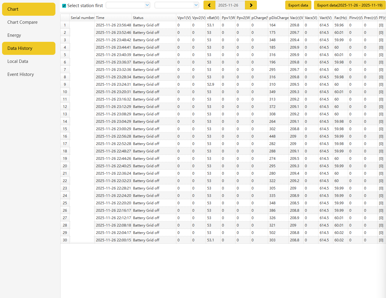

Trying to figure out how to download the data for the month of October 2025 but can only get data for one day as I can not find a date range entry location. Do I have to down load the data one day at a time?
You can't do monthly, but if you go to Data > Data History, you can export data for 8 days at a time. The option is located on the top right of the screen.
