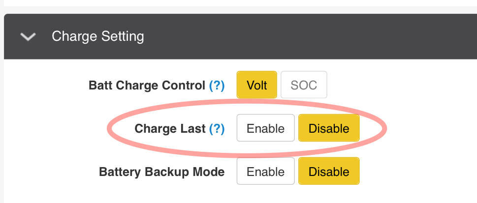

1. Have “Last charge” enable/disable be switched with a time schedule. For example I would like it so that it will switch at
IMG 3291
midnight to 11am - last charge enabled
11am to midnight - last charge disabled
As the 18kpv can only generate 12kw from pv, and me having 17kw of panels, I can export all excess power to the grid before 11am while the 18kpv is still below the 12kw ac threshold. Then at 11am, batteries start charging as well, allowing the 18kpv to then also send pv to batteries so  then 6kw can go to batteries and 12kw can go out on the ac side. Hence the name 18kpv. So have to do this manually everyday. If I say just leave last charge disabled, once the battery is full, the 18kpv then just clips all pv power above its 12kw ac limit. If I leave last charge enabled, it seems the 18kpv struggles to maintain sending the excess pv to battery consistently.

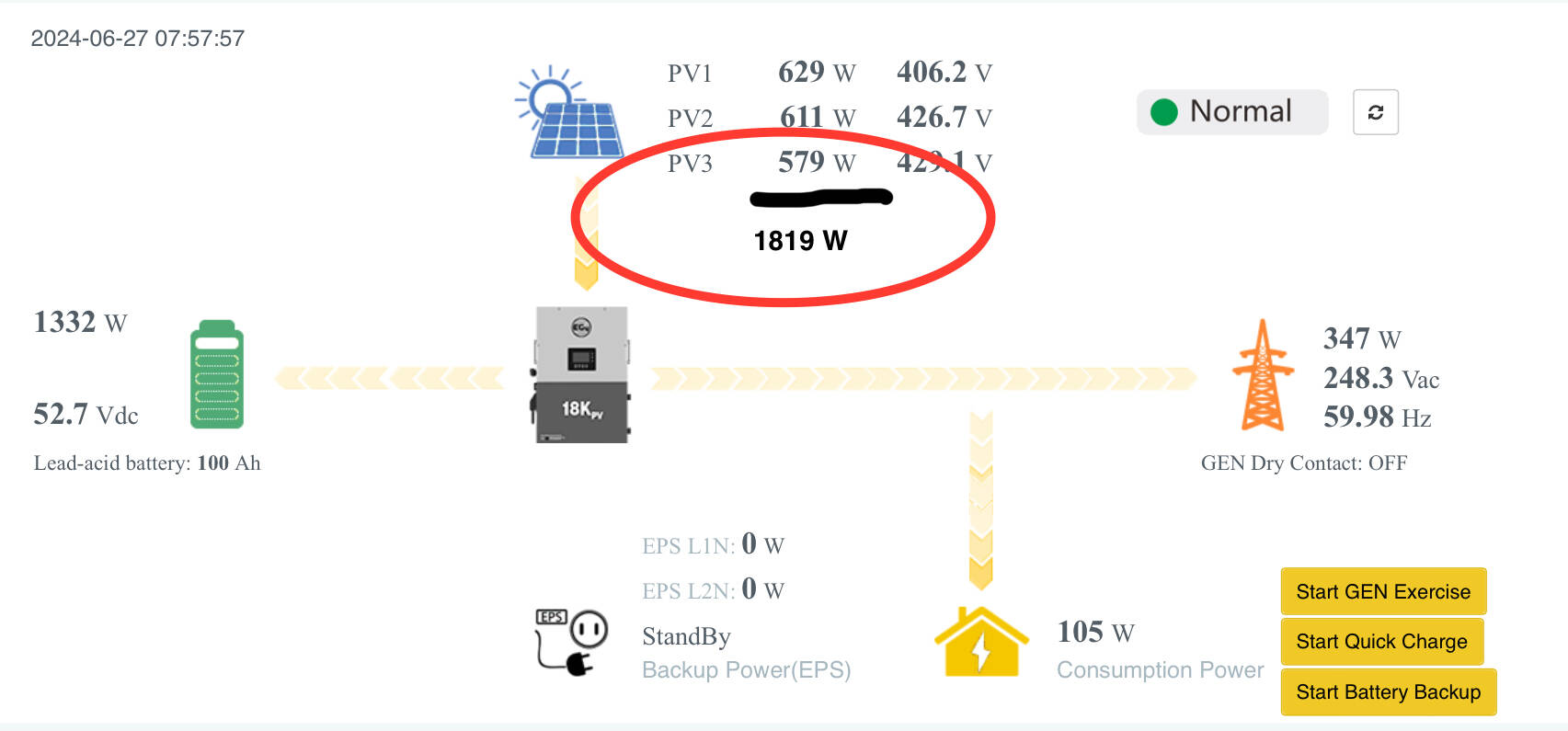

2. Have total pv wattage on the monitoring page like the app as in
IMG 3290

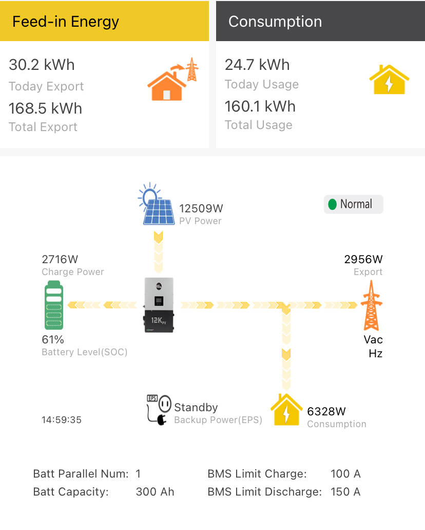

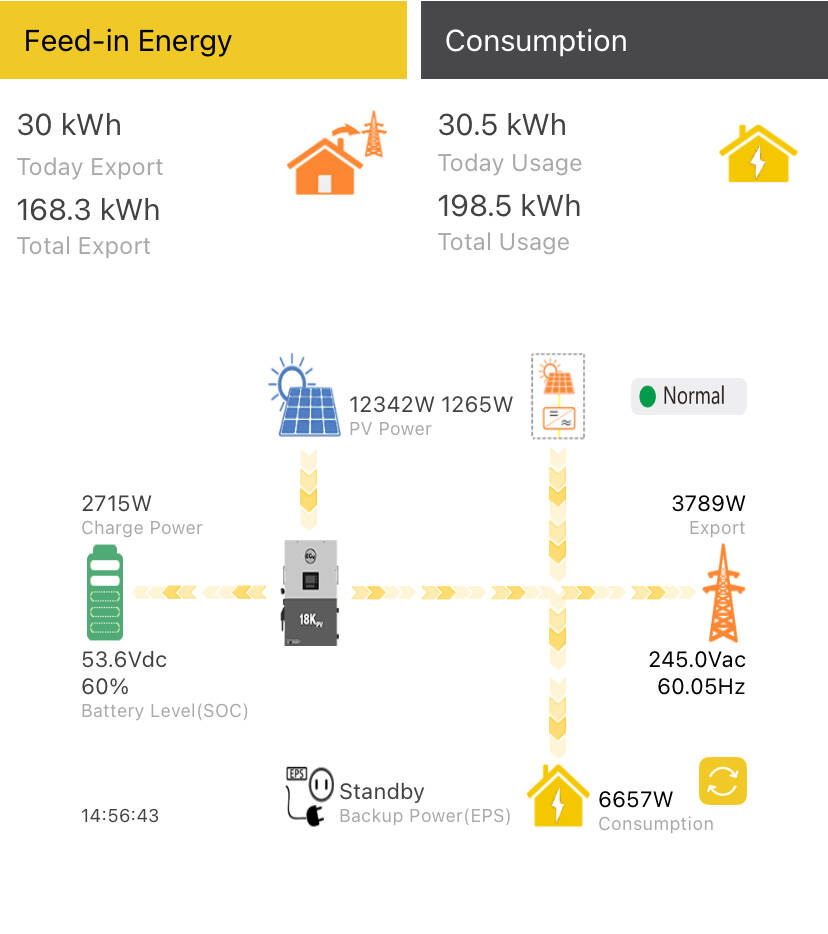

3. I have ac coupling running now, but it will only show that information on the app (IOS v1.5.3), if I connect online, but when I do a local connect it doesn’t show the data
online:
IMG 8178
local connect:
IMG 8179
