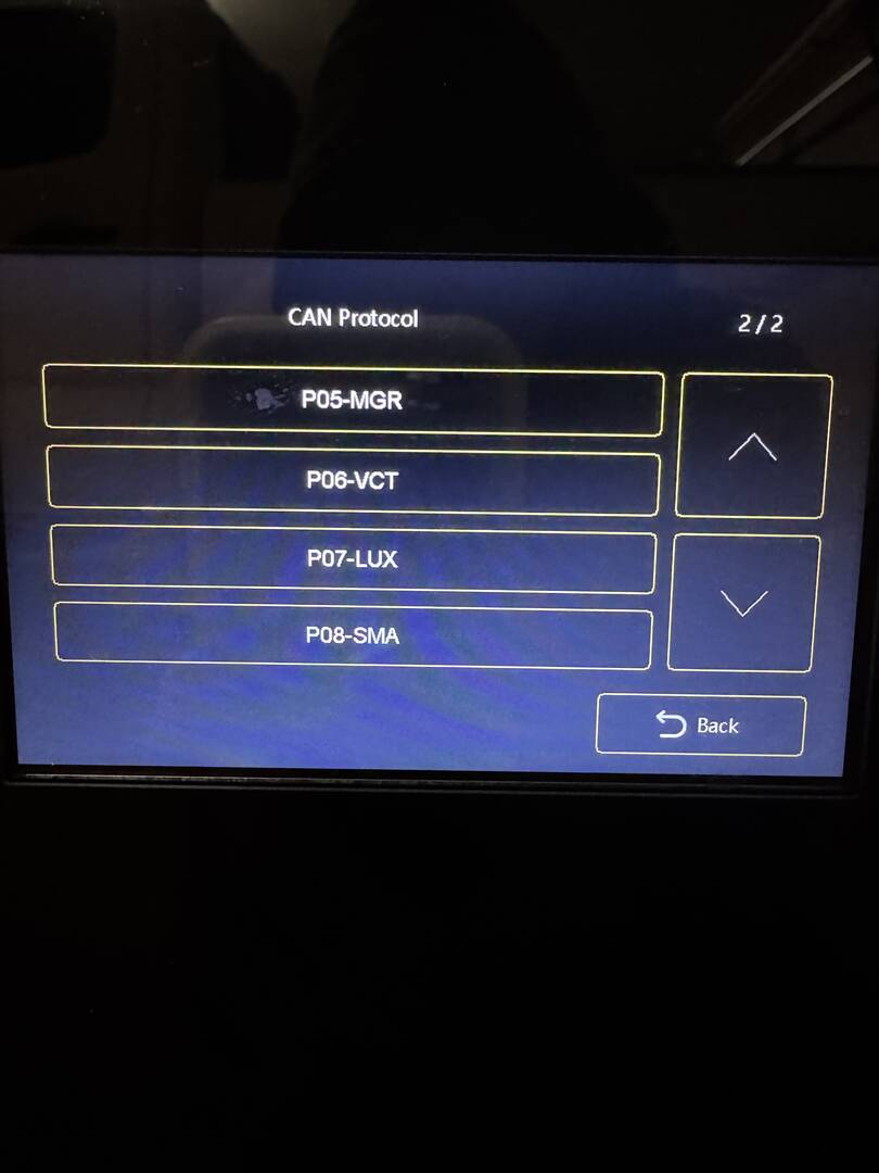

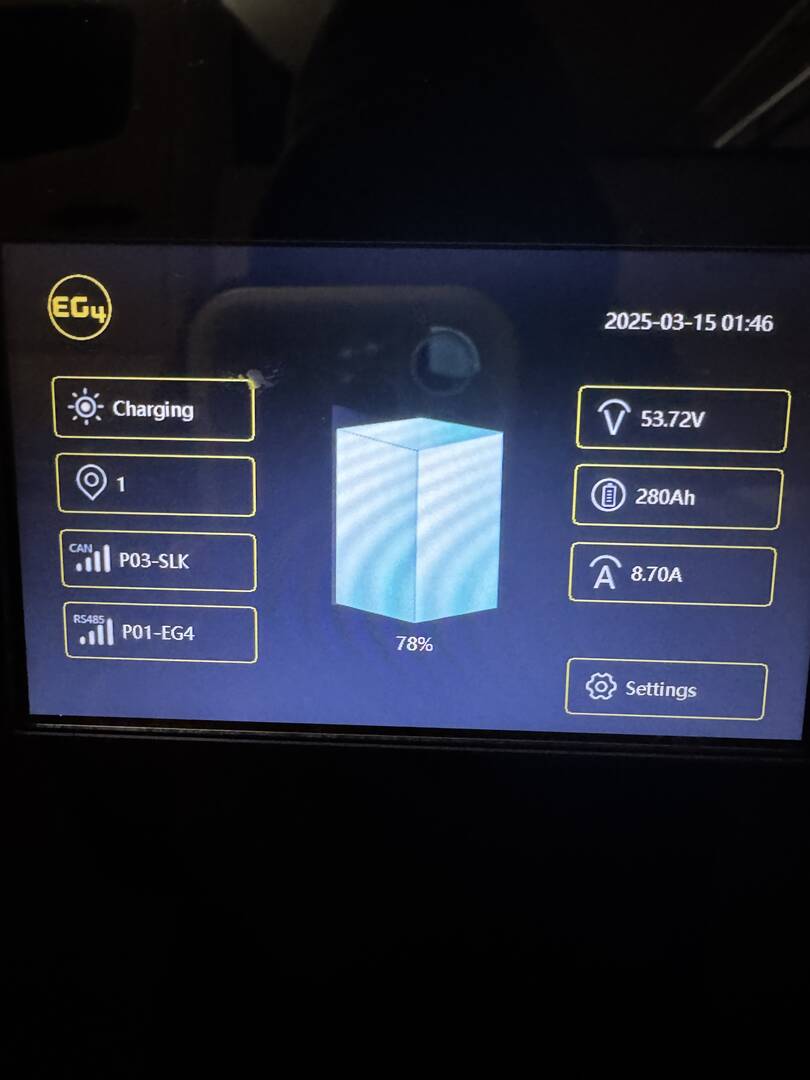

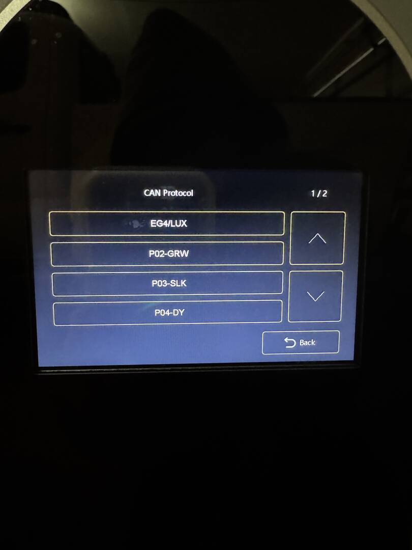

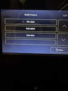

What protocols do you have set on the battery and also on the inverter?

Posts: 1273
These are the protocol for the indoor WallMount battery.

Posts: 1273
@danrpr1
You can watch this video; it explains step by step on how to get the WallMount battery to communicate with the Sol-Ark inverter. The information on the screen isn't correct.
These numbers may be too high, so you can try making them lower and see if that helps. The video shows different numbers on this screen.
