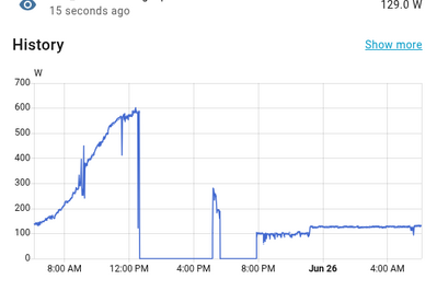

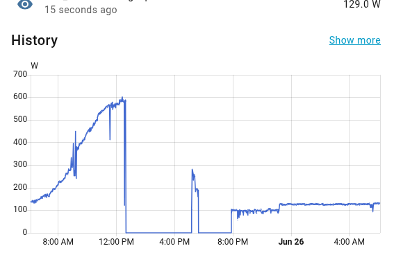

Does anyone else see Gen Power over 100W show up at night with AC coupled enabled for micro-inverter input?
Very often it'll show zero after the sun goes down but later on it shows around 130W of input in the darkness of night.

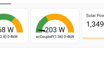

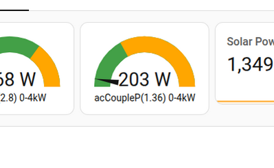

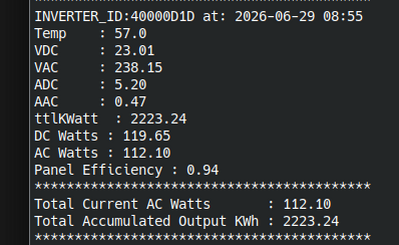

this morning, inverter says and current measurments verify, 112W but the EG4 says 203W and it's always about 115W higher than actual.

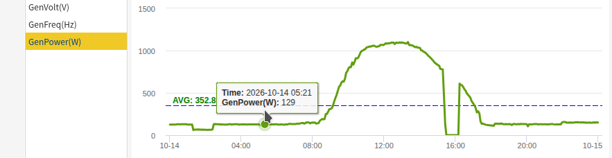

Are you seeing the same results in the Eg4 Monitor website?
(@dougl)
Posts: 89
@eg4eric yes, it shows up as shown in the web page capture below:
