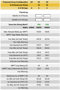

Hello, I just need quick clarification on the PV setting for my 12000xp.  My panels according to the calculator will be 4 strings of 10 panels each.  My question is do I set the PV input to independent or parallel?  Since it's referring to PV1 and PV2 in the manual I'm assuming that they should not be combined in parallel with these arrays.
