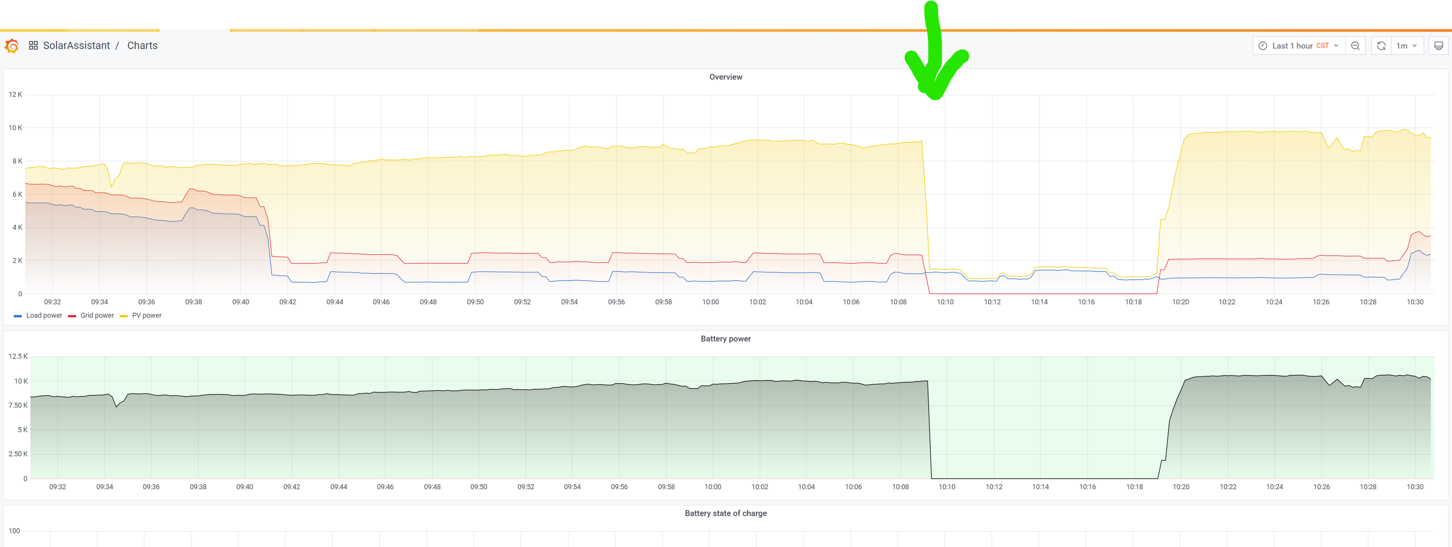

SOMETIMES, not all the time, BUT SOMETIMES when finishing the AC charge cycle ( i have it set to stop charging at 60% SOC), it will swap over to PV Off-Grid mode (basically wont charge my batteries) rather than the PV+BAT Off-Grid mode. I am able to force it out of PV-Off-grid mode by hitting the "start quick charge" button in the app
This is easier to visualize with the solar assistant chart.
The end result is that I have to sit here and babysit this thing or i lose out on a bunch of PV power! please help!

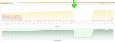

I do notice that the Batt Status goes to "2". unsure of why the batteries are affected by it swapping over.

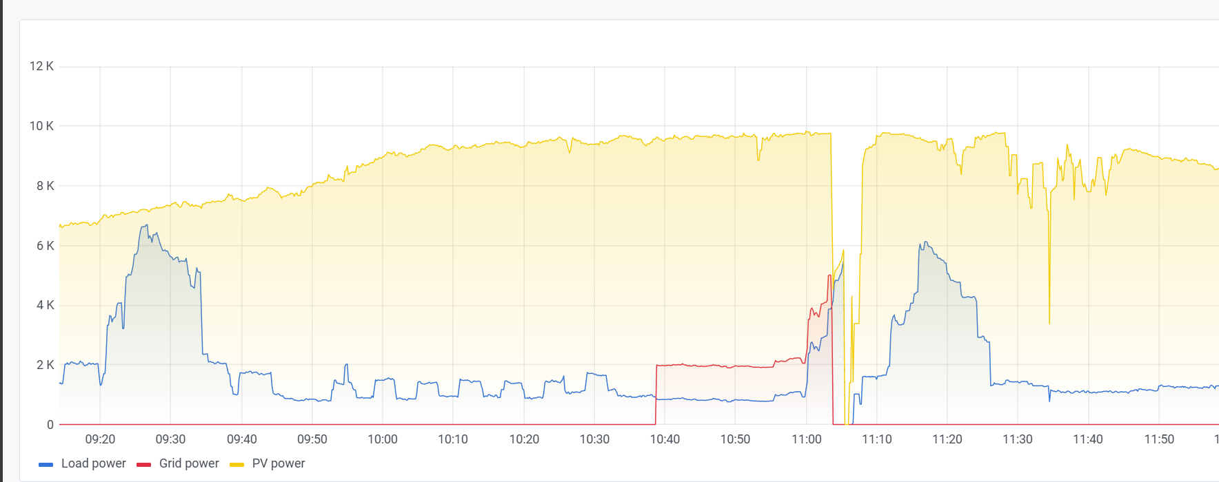

Ok new weird stuff happened today:
At 1038 it goes into pv batt/ac charge mode without any input from me.
Then at 11:03 it goes into that same PV Off-Grid mode.
it only recovered because I cycled both units.
I did notice that the battery communication cable was connected to the slave, so possibly that has something to do with it? Going to continue to monitor. really would like to see some logs on this. It should log and say why it's changing operating states!
If anyone has ideas, let me know.

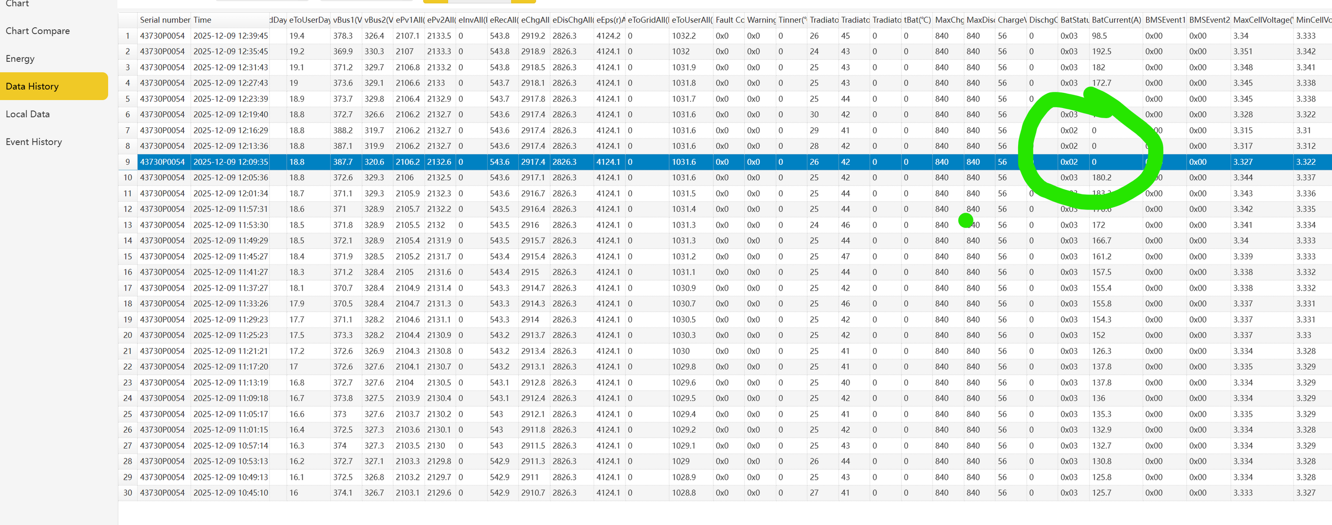

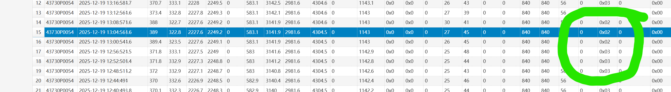

The only thing i notice thats different on the data logging is that the BATSTAT goes to 2 vs 3 when it goes into these ~10 minute periods of not working. (always during high solar output)
I cant find any documentation on what that means.
@clarktheshark

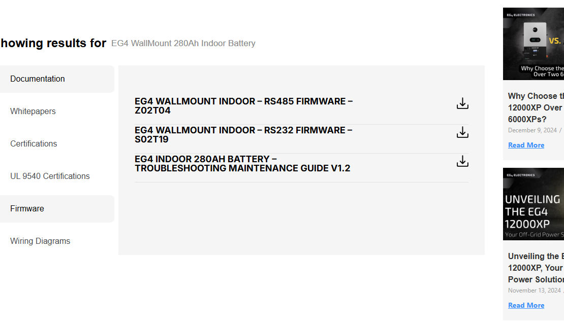

Are all the batteries updated with the latest firmware? You can check by using BMS Tools Software
We don't have any documentation on that; however, we have had this issue before and updating the firmware on all the batteries to the latest firmware resolved the issue.

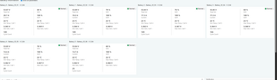

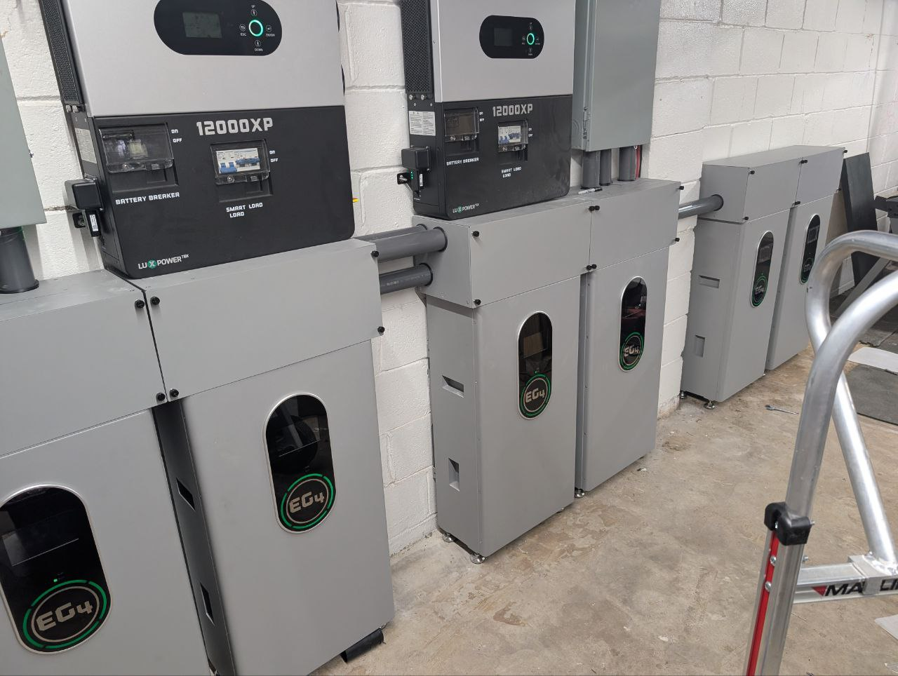

Can you possibly share pictures on how the batteries are connected and how the Master battery is connected to the Master inverter?

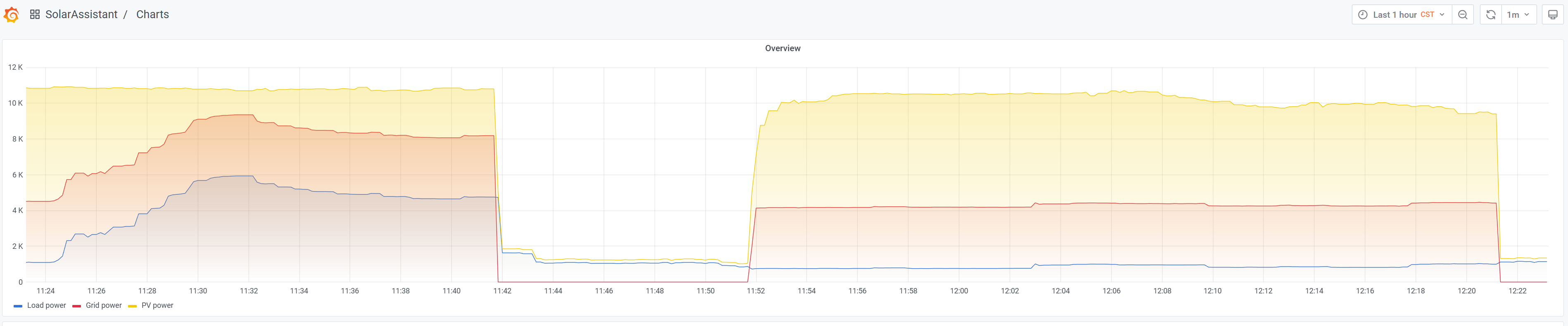

This is today. The charging always drops for exactly 10 minutes in the peak of the day. sometimes several times a day.
The install is fairly normal i would say:
- batteries are configured 1 through 6 from left to right.
- master 12000xp inverter happens to be on the right.
- I have a transfer switch configured to allow me to bypass the solar system when needed
- no generator
- batteries are configured as "shared" between both inverters.
@eg4eric

I would still recommend updating the batteries.
0x03= Charge allowed and discharge allowed
0x02= Discharge allowed and no charge allowed
