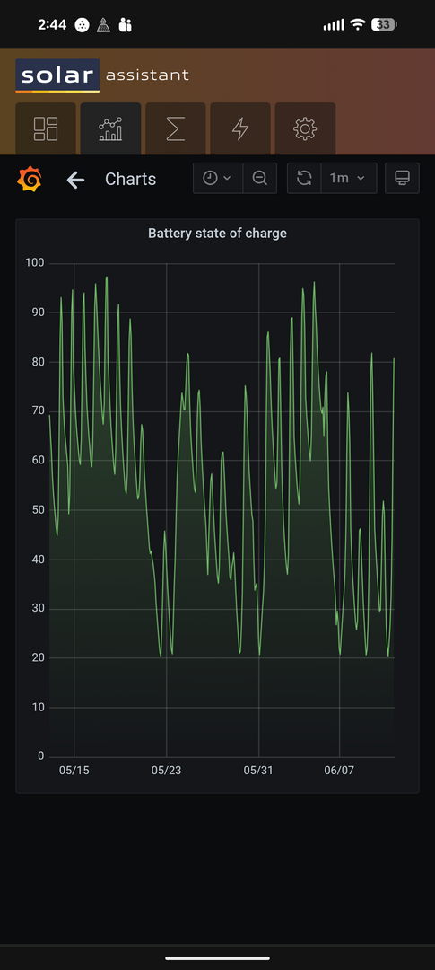

How low do your batteries discharge on a daily basis?
(@clarktheshark)
Posts: 24
Screenshot 20260612 144449
Here's a screenshot of the last 30 days state of charge.
It never goes below 20%. And though it doesn't look like it, it does hit 100% on those high peaks. (Just not for long)
