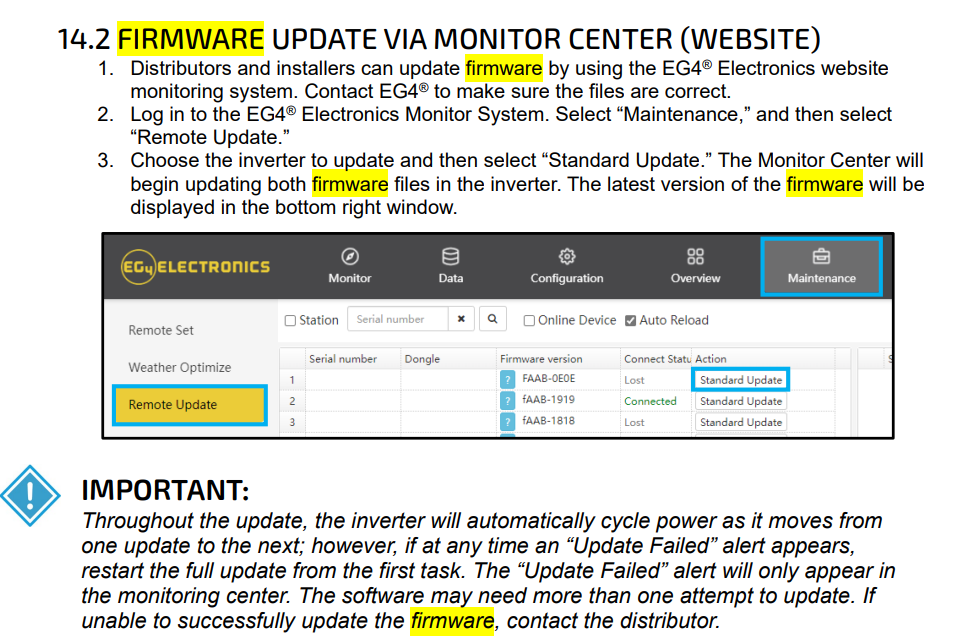

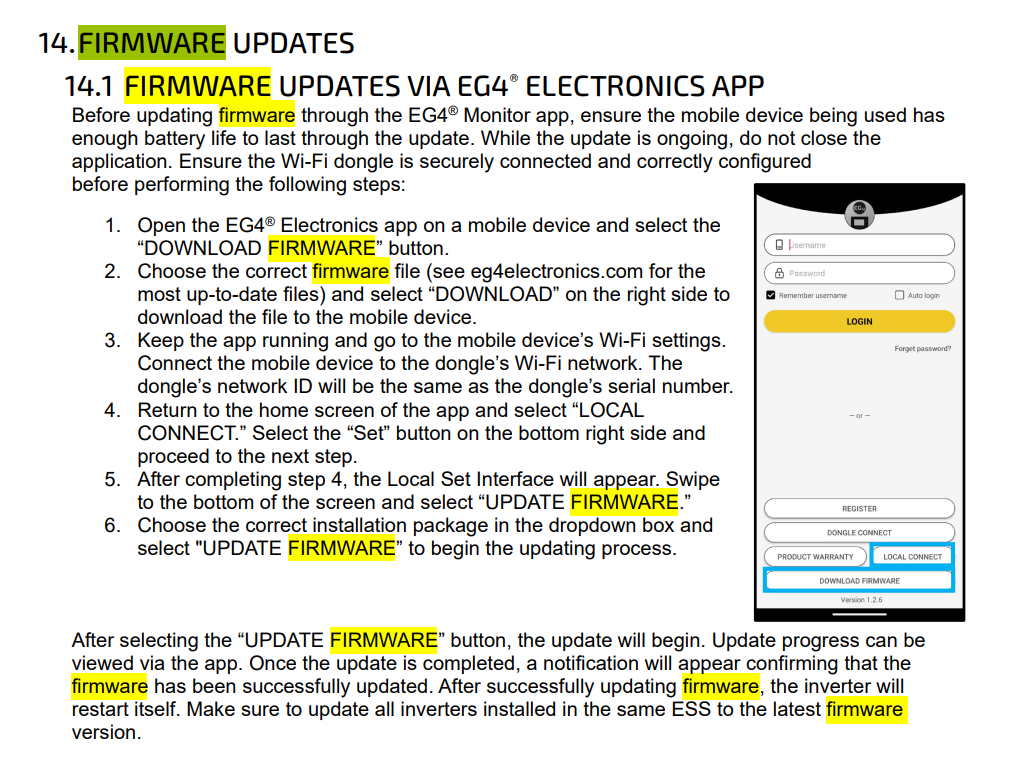

@eg4eric Thank you for suggesting this. Do you happen to have a link to instructions on how I should do that? I am assuming you are talking about the Flexboss firmware, and not the batteries also, is that correct?
@natwall1
You can update the inverter through the app or through the Monitor center (website)
