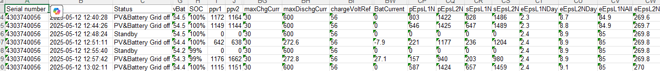

@eg4eric I have a EG4 Battery rack with 6 LL-S batteries for a total of 600ah.  When this happens batteries are at 100% SOC.  At that time systems limits PV to manage just the current load. It was close to 1pm and it was pretty sunny and I am sure the strings would have been able to pull the necessary load.
Discharge current limit is set to 140A.
I have attached an extract (few relevant columns) from the data logs here.

@eg4eric,  the detail of his system's solarPV input being curtailed down to only support the load is likely an issue since there's no way the MPPTs can ramp up power fast enough to handle the instantaneous ~1500W load from the microwave start-up. You likely nailed it asking about battery output limits and since the batteries are at 100% the power FETs aren't already on like they'd be during charging.
