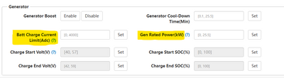

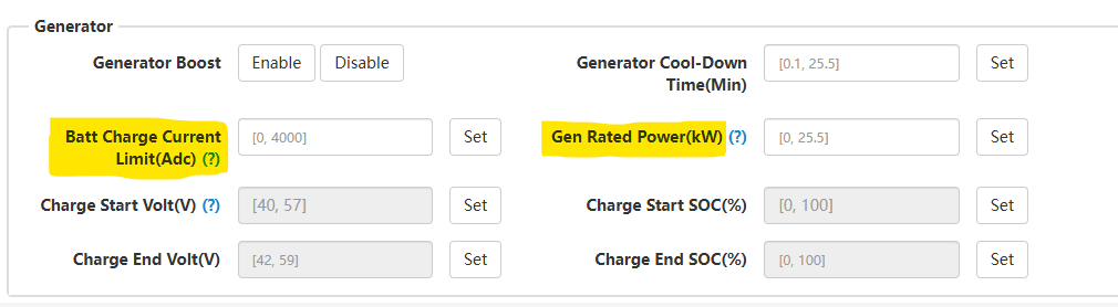

Unfortunately, the 12kPV wasn't designed to have the breakers replaced with smaller ones.
You can limit the amount of current used from the generator to charge the batteries and you can also limit wattage used from the generator.
