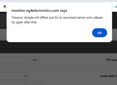

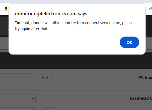

It looks like EG4 inverter settings no longer can be read/adjusted through EG4 monitoring web interface.

As per today evening the status quo is unchanged:
EG4 monitoring website can not read the inverter settings
yet the Station seems to be online

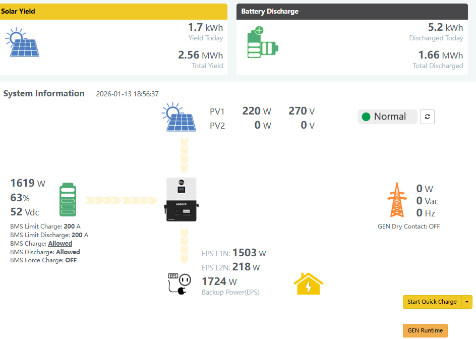

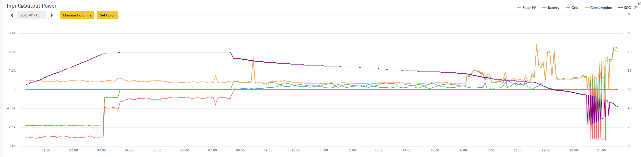

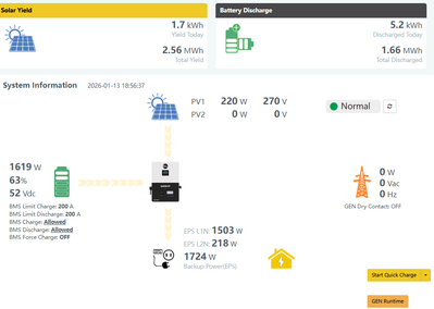

It does not work anymore. multiple restarts of the inverter does not help.
The EG4 monitoring website seems to show totally irrelevant data not corresponding to the actual inverter behavior
As per display the inverter is off-gri at 45% Soc, but actually it is on-grid and charging at 34%SoC of the battery
(@ranwei)
Joined: 10 months ago
Same here. 12000xp. The website can no longer read the settings from inverter since morning and there are bunch of timeout notifications on the inverter. The monitoring still works, but I doubt the accuracy of the monitoring as it tells me that I was using battery until 6:30pm when the inverter has AC First set to start at 4:30pm....
