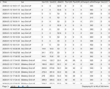

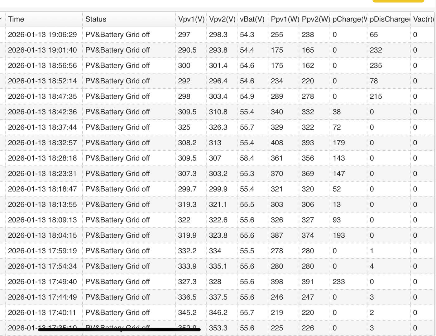

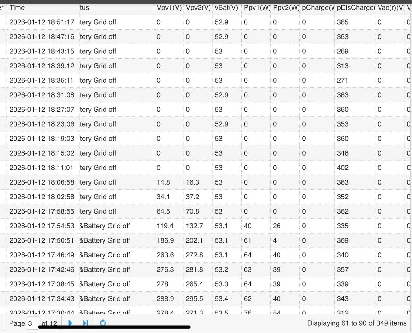

Anybody has an idea why it is pitch dark outside and the monitor tells me the panels are still charging? One photo is just now and one is yesterday, when they gradually stopped producing.

My data on the Device Monitor website tonight is delayed by 2 hours and 22 minutes from the actual local values. I haven't been able to change settings all day today either so apparently the EG4 server isn't playing nice today.
