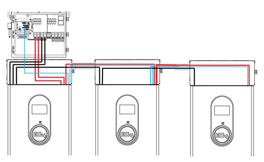

@eg4eric they are connected in series. The first battery is connected to the FlexBoss and the other 2 are chained after it. On a side note I also have the GridBoss and my solar is AC coupled to it. No solar is going directly to the FlexBoss

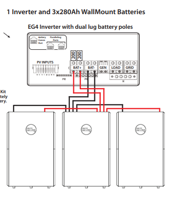

If possible, I recommend wiring the batteries as shown in the image below. I'm not saying that this will resolve the issue completely, but it could be the majority of the problem.
Do you know the voltage of the batteries when they are at 60% and then when they fail?
Just want to clarify, when you say fail, do you mean they are depleted, and they are at 0%?

Ok I will give re-wiring a shot provided the wires are long enough as the inverter is installed over the battery at the end. Coincidentally I did check with EG4 team before wiring it the way I did and they confirmed it could be wired that way.
As for the voltage I am not sure, but yes when I say fail they are depleted and at 0% and need to be fully recharged.

So I ran into an issue with trying to rewire the batteries. Due to the way it was installed originally, the inverter is installed over the battery at the end. Unfortunately the wires aren't long enough to go from the inverter to the center battery. Is there a recommended way to extend these wires? Is there anything you can provide which would help in this situation? As mentioned before I checked wit the EG4 team before having it installed in this configuration.
