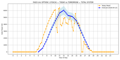

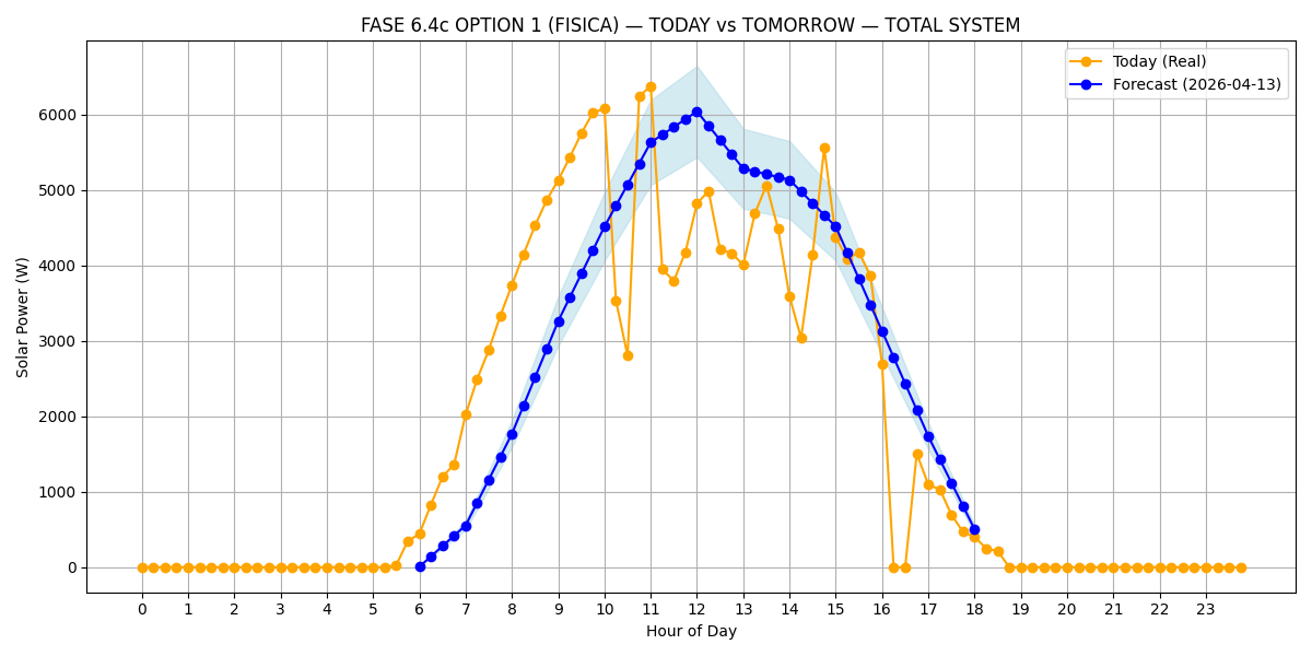

The output is a triple-curve forecast generated nightly: actual production (orange), ideal clear-sky potential (dotted bell), and a realistic prediction adjusted for every cloud in tomorrow's weather model (blue). The accuracy has been remarkably precise.
forecast hourly today vs tomorrow (1)
