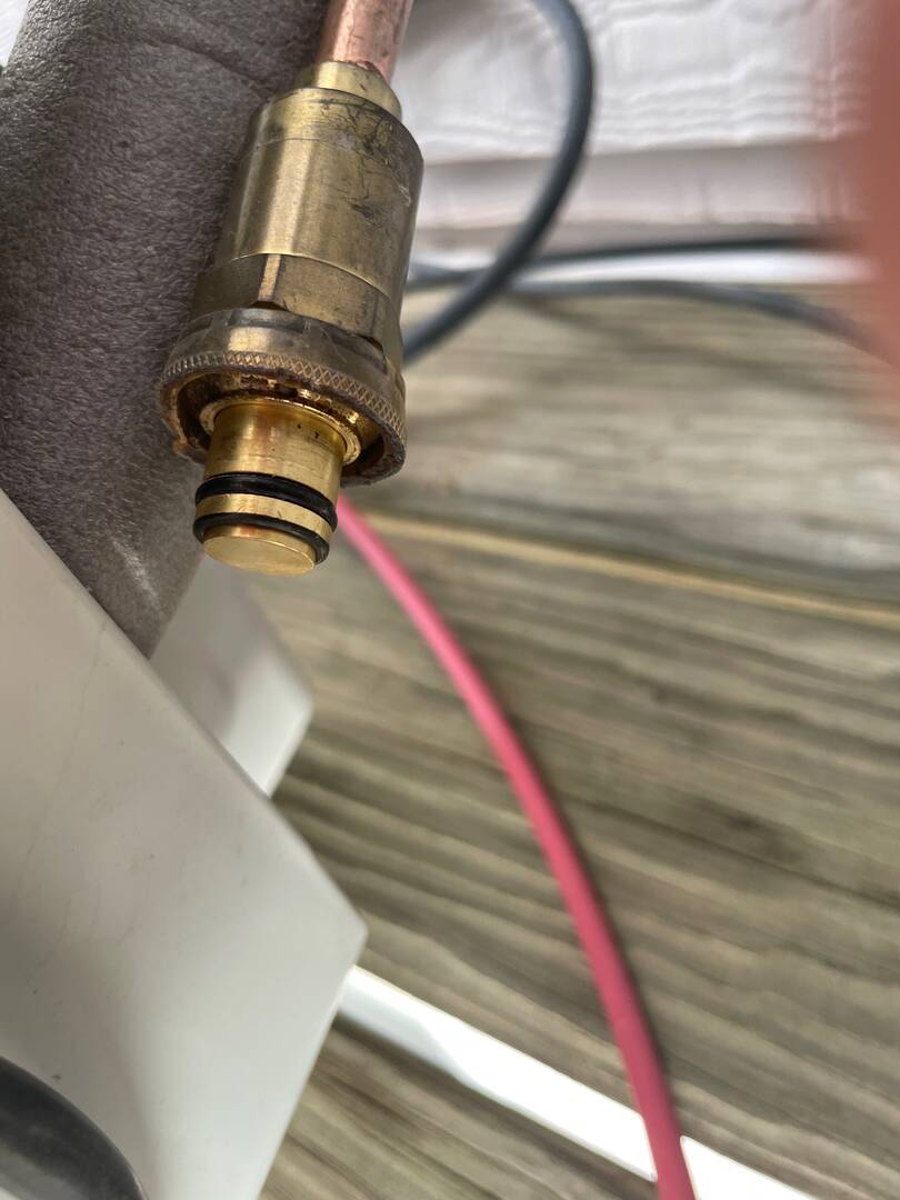

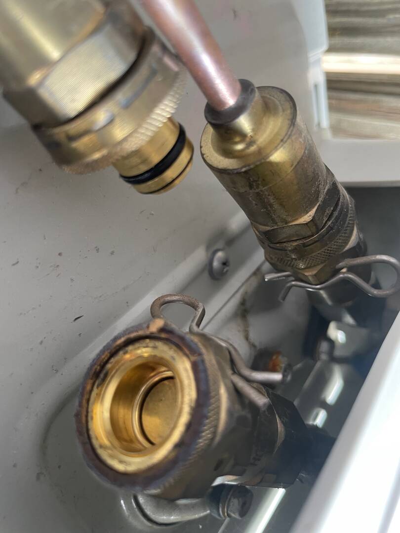

Forgive me if I am on the incorrect thread but tried to post yesterday without success.  My 16 month old 12K stopped cooling a few days ago.  The following morning I found the suction fitting/nut on the line set had cracked in half and the line pulled away.

(@2wiley)
Posts: 6
IMG 8191 Original
IMG 8187 Original
Posts: 1303
I can definitely help you out or at least point you to the right direction. So, are you only needing the Line set?

Thank You.  Joe at Signature Solar is working on getting a ticket opened with EG4.  A line set might fix the unit. I am guessing the refrigerant escaped unless there is some protection in the line set.  I don’t know how these pre-charged fittings operate.
