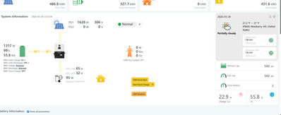

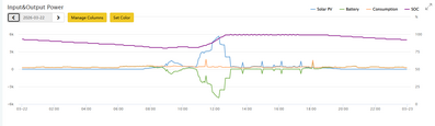

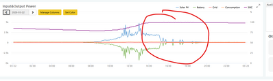

In February I updated Firmware on my 2 - 280AH indoor batteries as well as my 6000XP.
So far very happy with the changes but I have noticed something strange in the monitor system regarding the SOC.

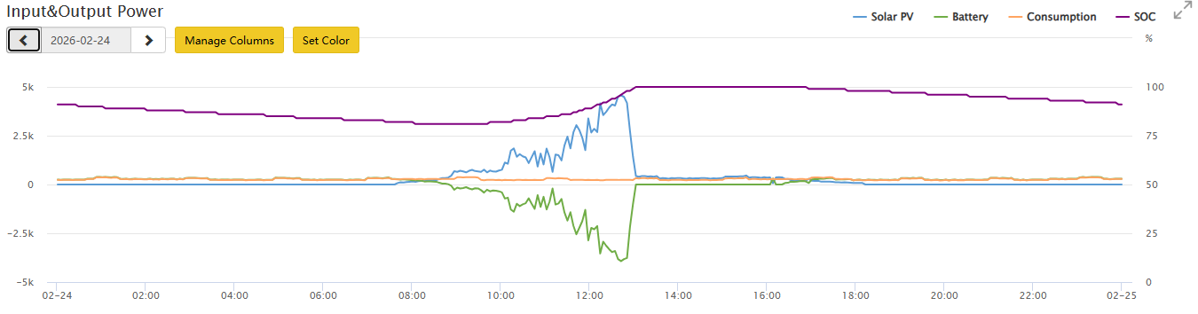

Prior to the updates, when my SOC reached 100% it pretty much stayed there.  Now, shortly after reaching 100% it dips to 99% for a little while and then back to 100%, then shortly after dips down to 99% again.
Before Updates:
Before
After Updates:
After
Is this because of the new logic in the batteries that recalculates SOC for small load draws?

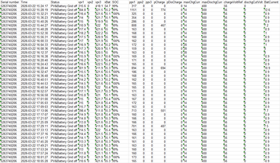

I looked at the data logs and it seems the batteries are discharging at ~0.9Amps (while there is available solar!!) ... the discharge forces the batteries from 100% to 99% and then the available solar charges them back to 100% ... this repeats until there is no more available solar (sun goes down) as far as I can tell.

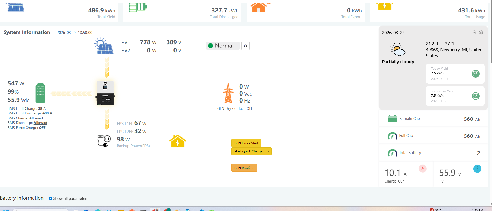

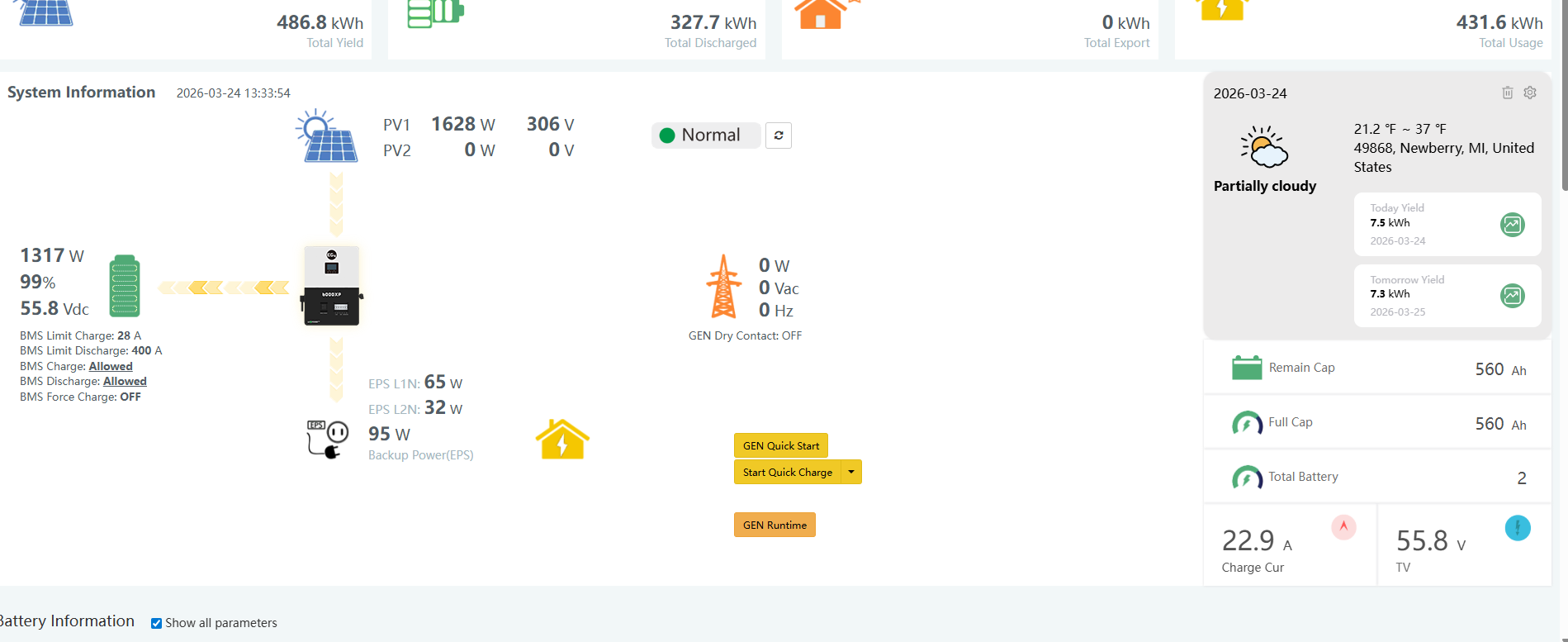

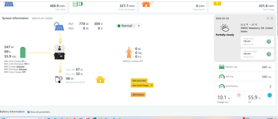

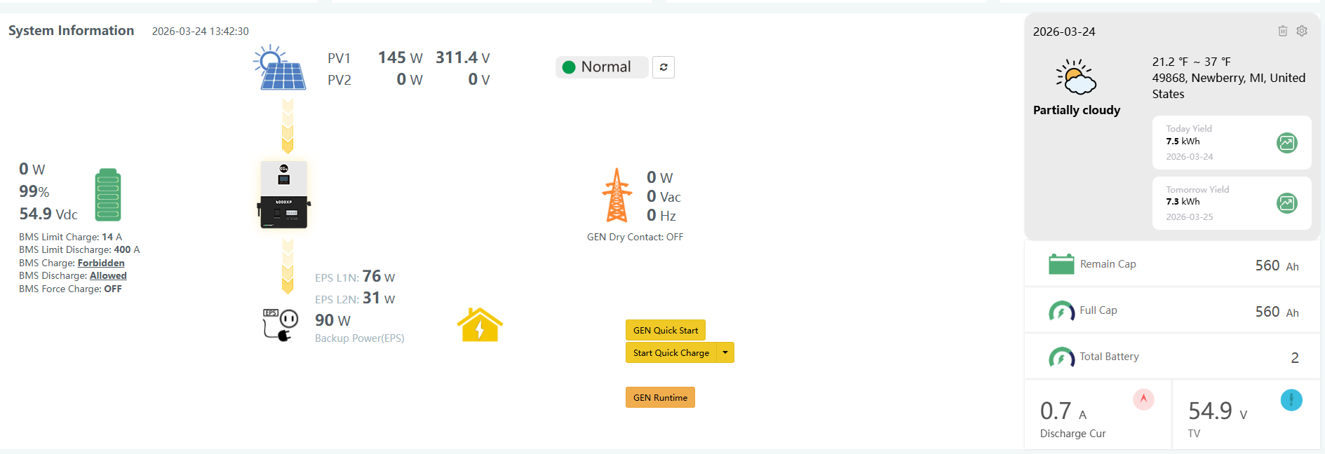

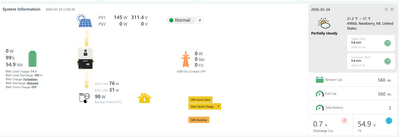

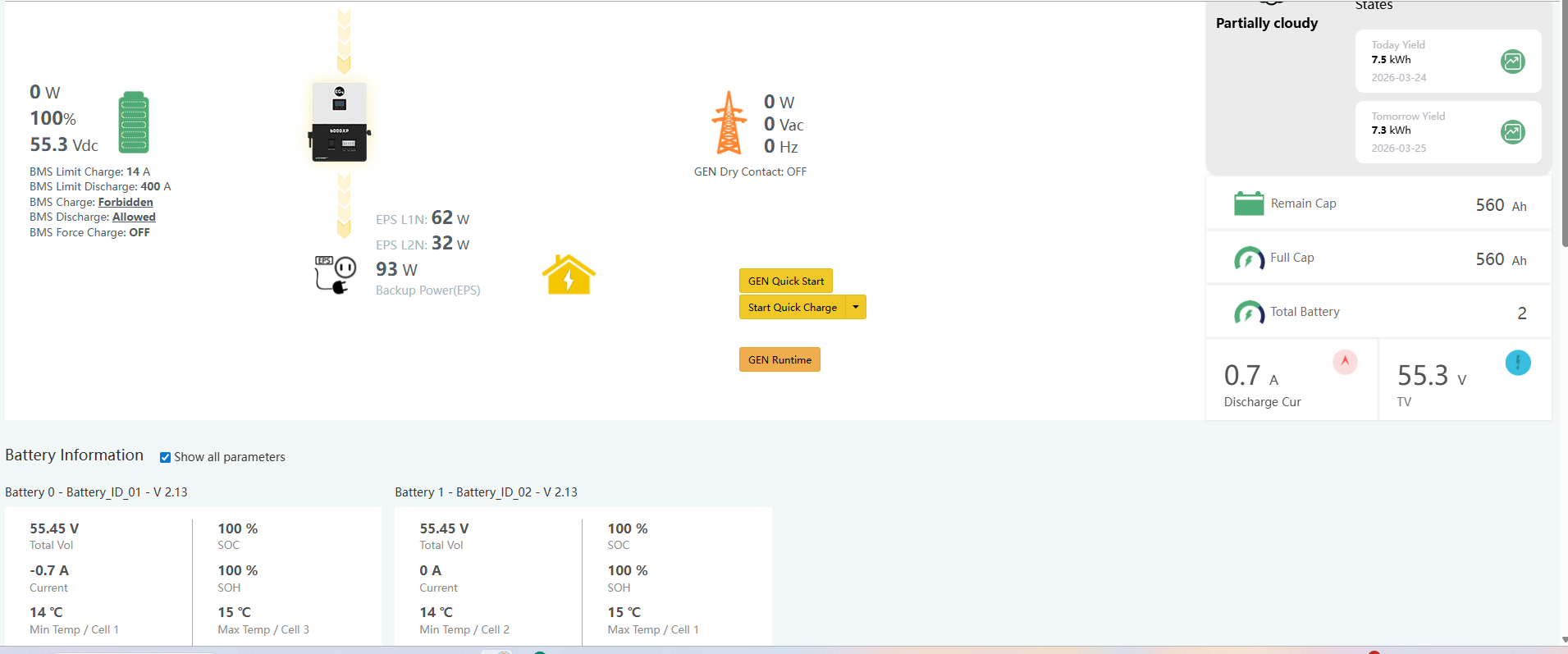

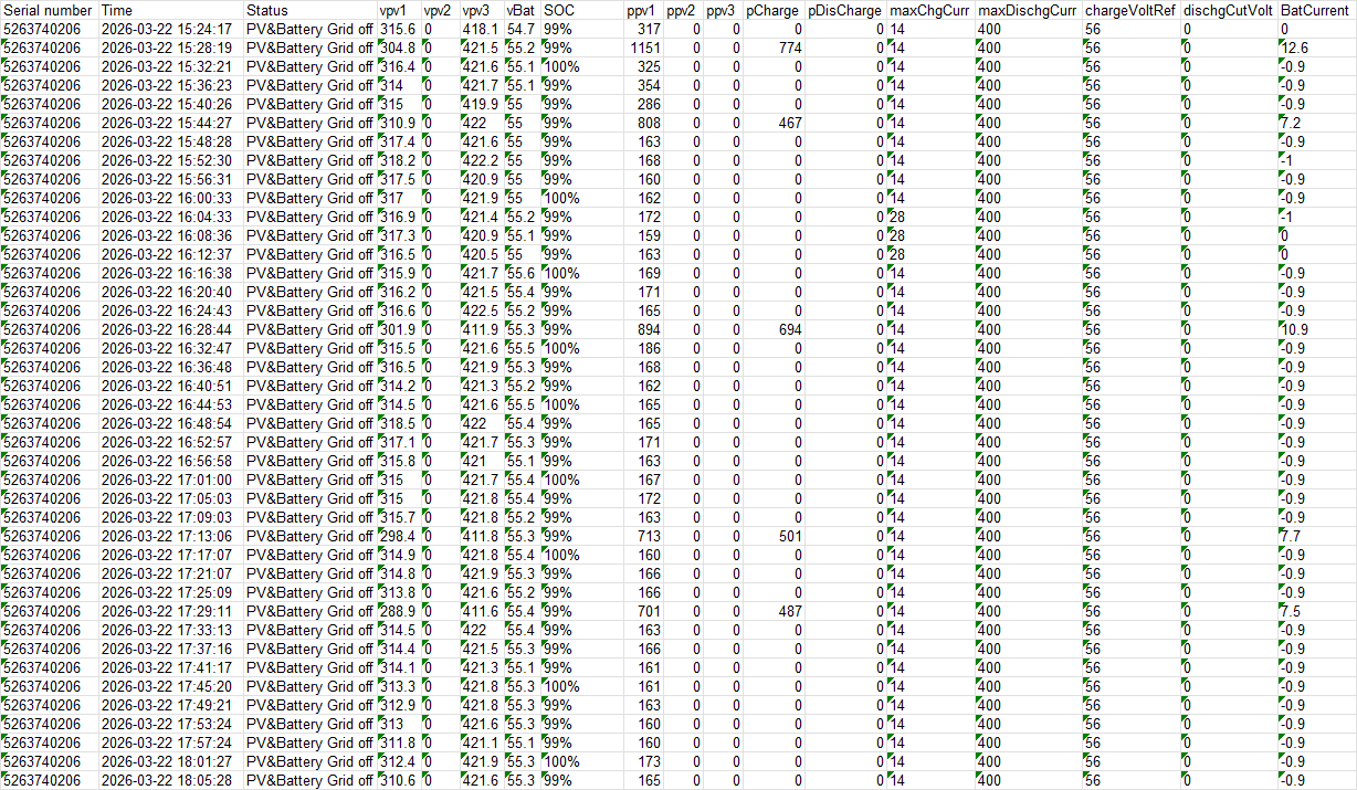

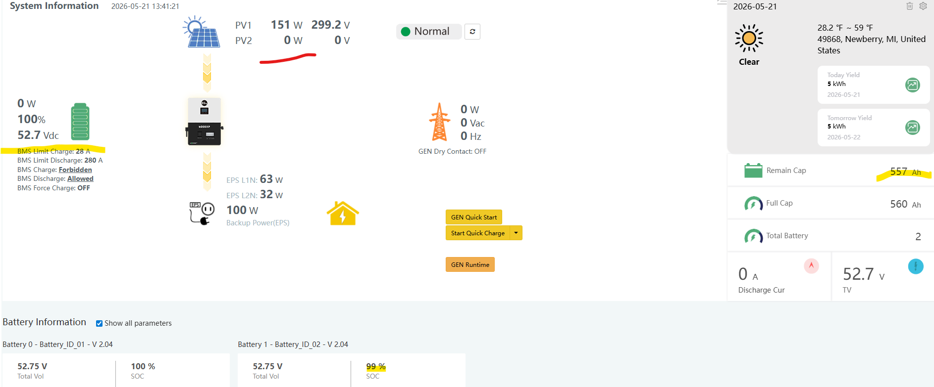

2 sets of screenshots ... Solar charged batteries to 100%, then solar cutoff but battery discharging at 0.7A ... will do this until batteries get to 99% then solar will charge batteries back to 100%.
Thinking the bouncing between 99% - 100% SOC is not a good thing??
I can share station name / serial number as needed.
Thank you.
99% to 100% ... discharge at 0.7A even though solar power is enough to offset consumption.
Screenshot 2026 03 24 133641
Screenshot 2026 03 24 133735
Back down to 99% and charge back to 100%

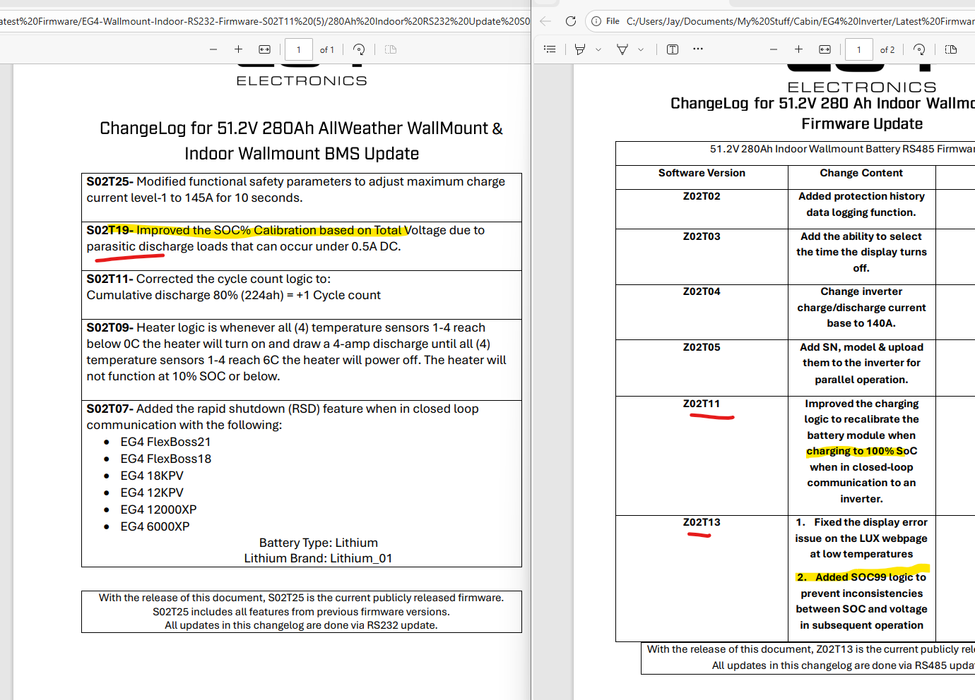

Based on the change log posted above by @yooperjay, I am assuming this has to do with the inverter now taking more granular readings of the battery to prevent inconsistencies in SOC due to parasitic draw.

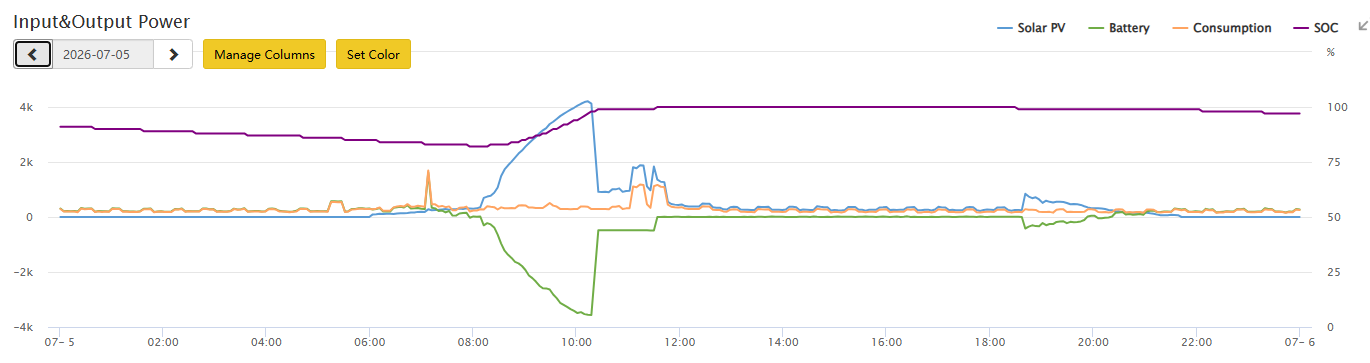

Update:
It appears that either my batteries have completed top balancing or there has been a change in the monitoring site.
When I reach 100% I am no longer seeing the dip and spike in the graph except when there is a large load such as my water pump kicking on.
Hope this helps other,
JB
