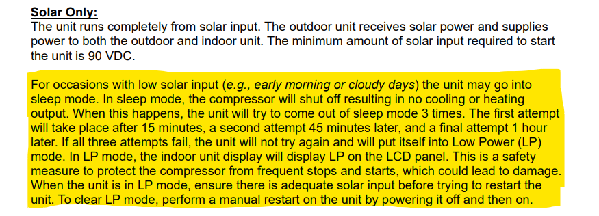

Posts: 1290
When there is not enough solar, the mini split will attempt to come out of sleep mode 3 times. If all three attempts fail, the unit will not try again and will put itself into LP (Low Power) mode to clear the LP mode, you will need to perform a manual restart on the unit.
