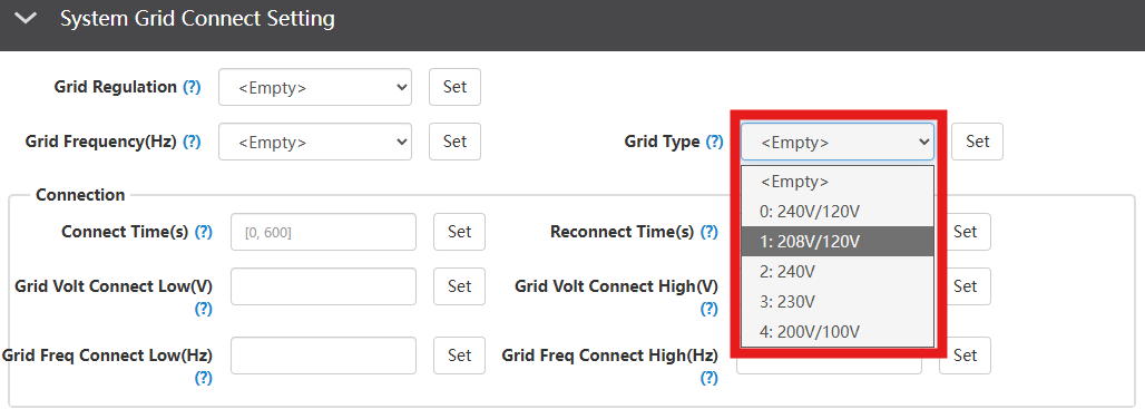

does anybody know if the 12kpv inverter can be hooked up to a 120/208 V 3wire system. My present conext XWpro 6848 can not and I had to get an auto-transformer to supply a 120/240 single phase split-phase.

Yes, it can. You can change the Grid type in the settings. If you need assistance with this, please let me know!
I want to add, that you will need to have 3 different inverters to have 3-phase 120/208.
