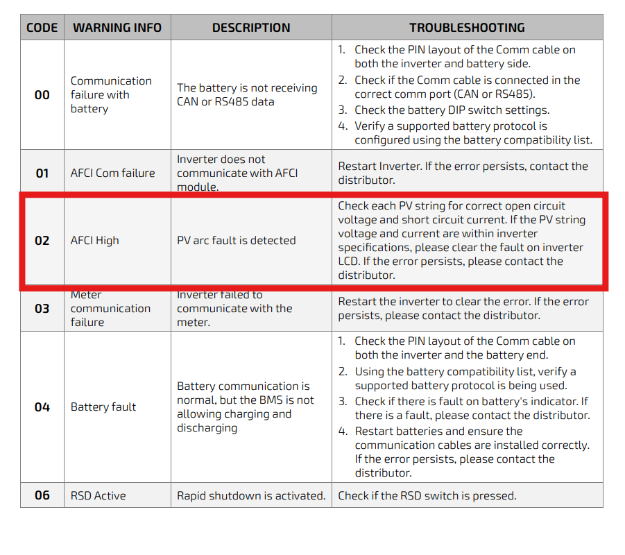

The EG4 6000XP manual states the inverter has "safety features such as PV Arc Fault Protection and PV Ground Fault Protection." Does anyone know how these are implemented. If it detects a fault, Does it stop drawing power from the PV array? Does it trigger RSD? Does it simply post a fault warning in the inverter display? I find no discussion of AFCI or GFDI implementation in the EG4 literature.
Especially; does the EGC from the solar array need to be connected to the 6000XP PE bus for PV arc fault protection and/or PV ground fault protection to work (rather than running the EGC directly to the main load center ground bus and the "One" grounding electrode for the system)?

If there is a PV Arc Fault or PV Ground Fault detected, the inverter will show a 02 Warning (AFCI High), the inverter will not shut down, it will keep running.
The EGC does not have to be connected to the inverter in order for the inverter to detect those faults.

Your comment the inverter will not shut down is counter to the 0/03/2025 at DIYSolarForum.org, where a 6000XP user stated. "In three months of operation, I've had two occasions where the W002: AFCI high Notice was triggered. The result was a shutdown of the PV and also the EPS output."
Which is true?

Or did you mean the PV input will turn off and the EPS output will turn off, but the inverter box will not turn off?

The inverter will not shut down, it will remain on, but the PV will shut off. I am not sure about the EPS being shut down, but I will investigate and confirm.
