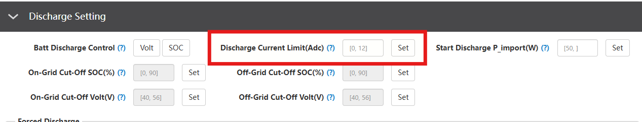

I have 2 6000XP in parallel.  According to the manual, each 6000XP AC BYPASS (GRID) is rated at 50A (12KW) - total 100A/24KW? But, when the load draws over 50A/12KW, I get "EPS overload" warning from both inverters.  Is that because "EPS" can only supply 25A/6KW each, or 50A/12KW total.  When demand exceeds 12KW, the system switched to BYPASS mode, but logged "EPS overload" to indicate that it went into BYPASS?  Just want to confirm that while I exceeded the EPS capability, I did not exceed the system capability...just forced it into BYPASS mode.
3 Replies
Posts: 1290
Make sure you have the Discharge current set to 280A. This has to be manually changed or else the battery discharge will be set to 140A which is what only 1 inverter can handle.
When the load demand exceeds what the PV and battery can supply, the system will bypass to the grid.
