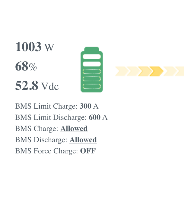

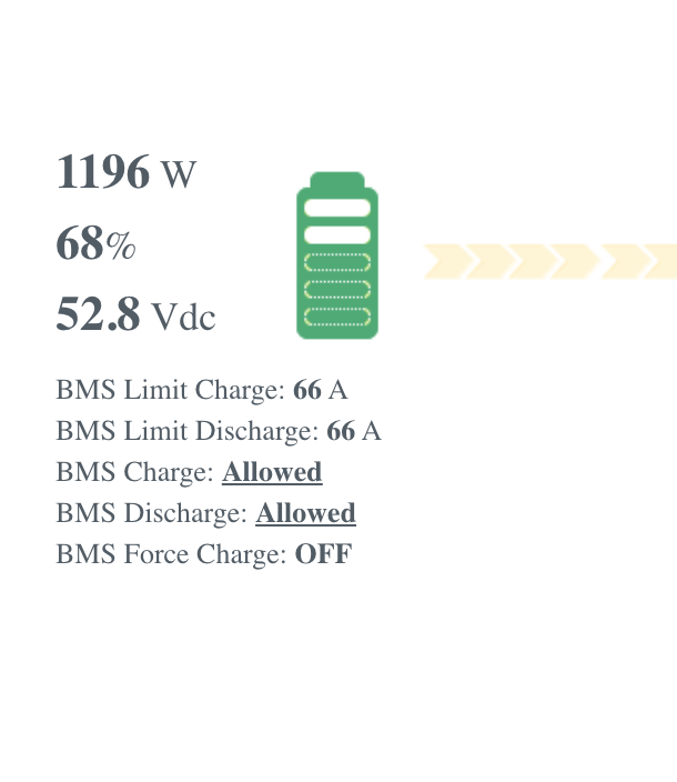

I have an off-grid setup with 2 EG4 18kpv Inverters in parallel.  I also have 2 banks of 6 EG4 LL Batteries for a total of 12 or about 60kw of battery.  When I view the Inverter monitors web they give me confusing and differing data for the BMS.  My Parent Inverter says
BMS Limit Charge: 300 A
BMS Limit Discharge: 600 A
While my Child inverter shows
BMS Limit Charge: 66 A
BMS Limit Discharge: 66 A
When I view the same screen on the App it shows those same numbers but the Parent Inverter also says:
Batt Parallel Num: 6
Batt Capacity: 600Ah
While the Child Inverters states:
Batt Parallel Num: 0
Batt Capacity: 0Ah
I must have a setting wrong somewhere but can't figure this out.
Screenshot 2025 11 16 at 4.50.03 PM
Screenshot 2025 11 16 at 4.49.53 PM
